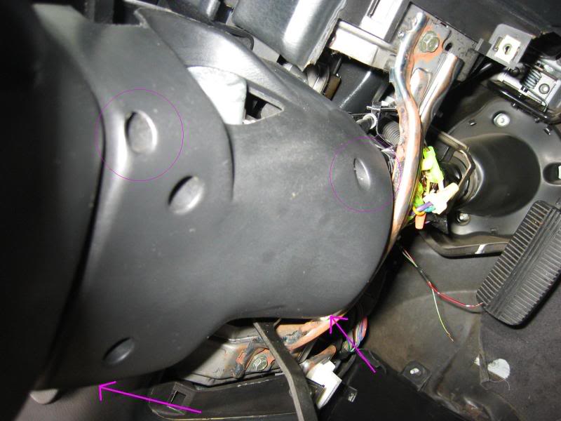

In order to get the plastic piece in front of the guage cluster, the top plastic cover of the steering column has to be removed.So to do that, remove the following screws

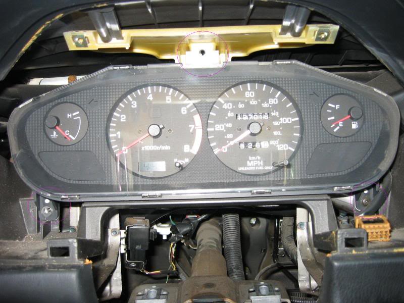

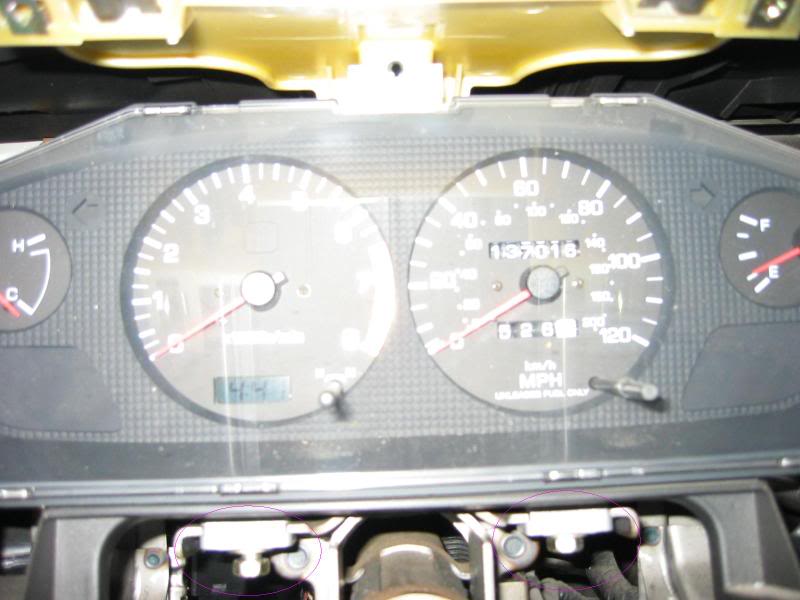

Take these 3 screws out

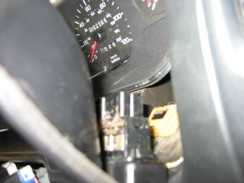

Unplug these wires

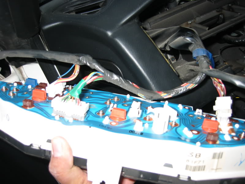

I replaced the top three (Orange) and bottom right( Blue)
Switch them out
***NOTE*** Make sure you test it out first before putting it all back together...one of my bulbs didn't work but good thing I ordered 5. To test it, plug the wire that went into the dimmer, and the lights should come on.
I'll post a pic up tomorrow of how they look like....to be honest, I thought they were going to be brighter, but I realized if they were brighter it would hurt the hell out of my eyes lol.
