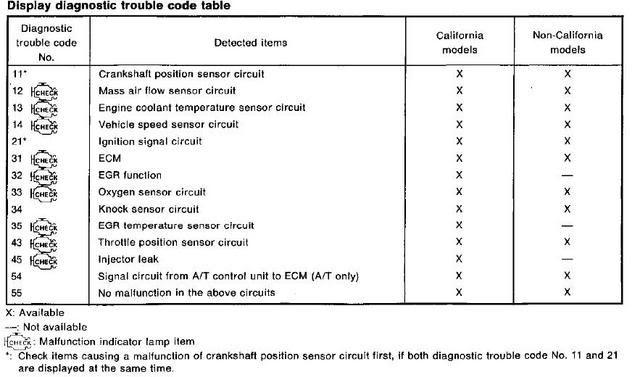

ryguy Jul 21, 2007 09:38 PM
1 Attachment(s)
The check engine light is not supposed to go on. However, I had the same code being thrown and my light was going on every so often too.
Attachment 21672

jramosthe1st! Jul 22, 2007 02:36 PM
no not really a faulty knock sensor is not a good thing regardless if the light comes on or not.
ryguy Jul 22, 2007 04:43 PM
ramos is right, I wasn't saying you shouldnt have changed it, I was just saying that it's not supposed to throw the CEL, but for some reason it threw mine too. Do not be mistaken, your knock sensor did have to be replaced.
Initial Daniel Jul 22, 2007 04:52 PM
Yeah, thats what I read also...it's not supposed to throw a CEL. Definitely replace it though, if it's bad...
