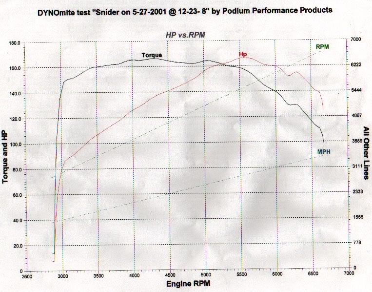

With a new tune higher octane fuels can be used and actually change response to the knock sensor to increase timing and fuel dumping. The dyno that I am going to show utilized 104octane, although I find it to be unnecessary since the KA runs a compression at under 9.5:1....96octane will work fine to achieve these numbers. This dyno used all the modifications I just stated....
Attachment 27511
Now this is direct power at the wheels I was here to prove numbers at the crank. If you break down the 26% (32hp stock loss) degradation loss that the KA transmission and power steering pump makes that leaves you at about HP at the flywheel. So total spent was $760.00 plus or minus a few dollars and these are do it your self mods. Devious KA (Gabe Z) of NICO can sell you a 1 time tune to achieve these numbers for $100, do not go through JWT I do not advise it for the price, and Gabe can sell you a much more aggressive tune......... So for those doing a 1 time tune the cost it now $860 plus or minus what ever your shipping charges. So if you didn't notice I didn't add a intake or filter which would put you at 4 more HP. Or a high flow CAT that would add another 5HP for about $120 ( I got my CATCO for $50 and welded my own flanges). That my friends puts you at 215HP at the crank and 1 HP less than the sr20det swap. So is the KA still worth achievable numbers..... YES

Now can I back up these dyno's??? Yes with a Dyno of my own using 95Octane and stock timing.
Attachment 27512
