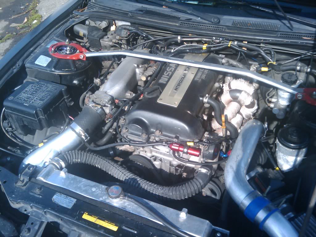

Ok, well I got the colder plugs, 18psi is a lot of fun
Decided to clean the car and engine block today:
Before: (6 months ago)
After:
Last week:
Today:
Edit: Adam, did you do anything to your tranny before building the engine?
