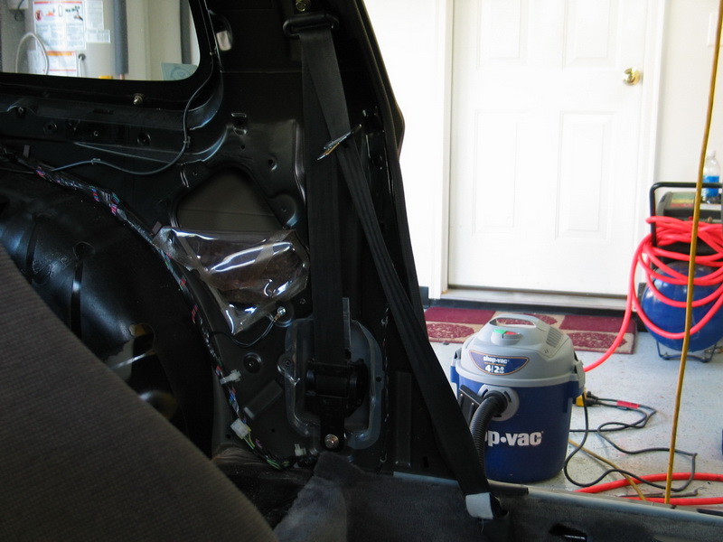

01. Manual seat conversion. I hated those power seat belts before I even owned the car. So I bought some s14 seat belts for $40 a while back. Finally got around to installing them. Lucky for me I have no desire to keep the interior trim pieces so I just removed all the panels associated with the swap. I'm glad I did too. Getting rid of those horrible belts I must of dropped 20 lbs from the car.
I had to make some brackets but they were pretty straight forward.

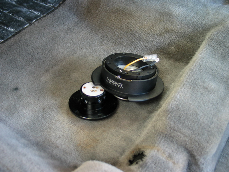

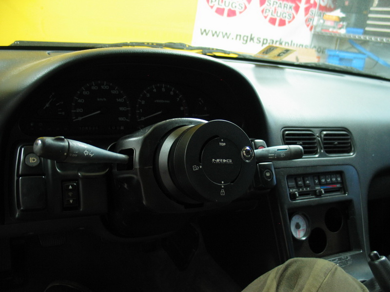

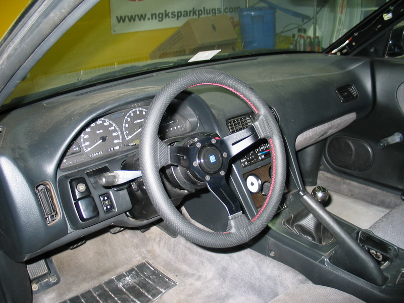

03.)New steering wheel. I've been wanting one for a while. I bought it through weaksauce.org. Collin' hooked me up pretty well. I got a Nardi Deep Corn 330. I'm gald I went with the 330. At first it felt too small but it feels much better than my stock already. Looks like a million bucks plus it has the quick release/lock for the added security. The looks you get walking into a restaurant with a steering wheel in had is priceless. It was also my birthday present to myself. I saved for a little bit.
The hub & quick release.
Mounted up.
Locked up.
Enjoy.

are the seatbelts a direct bolt on? or do you have to fab up a braket for it?
by the way sweet gauge cluster in the radio area.
Old May 5, 2008 | 10:14 AM
Bumnah's Avatar
Joined: Dec 2006
Posts: 434
From: VA
you gotta read bother. It's the fastest way to get flammed.
