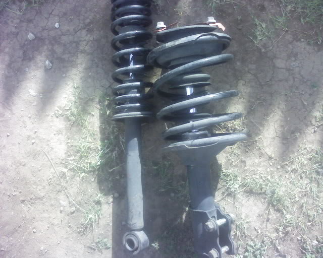

http://img363.imageshack.us/img363/7128/1011539my3.jpg
http://img363.imageshack.us/img363/3023/1011540tl5.jpg
http://img363.imageshack.us/img363/7645/1011542mk8.jpg
http://img363.imageshack.us/img363/5994/1011543lk6.jpg

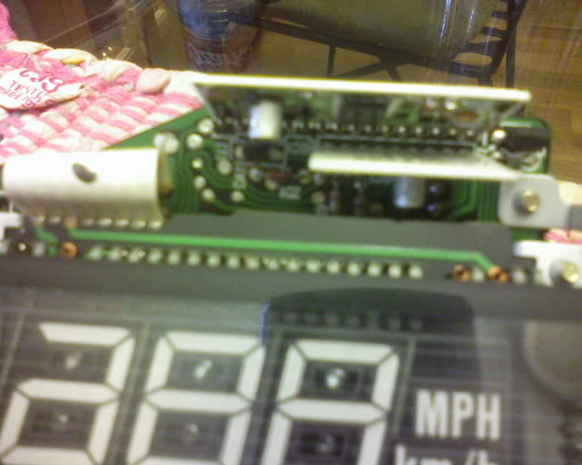

i tested it the way the "website" said to do, by heating the capacitor up
and seeing if it charges, but not luck. it didn't work.

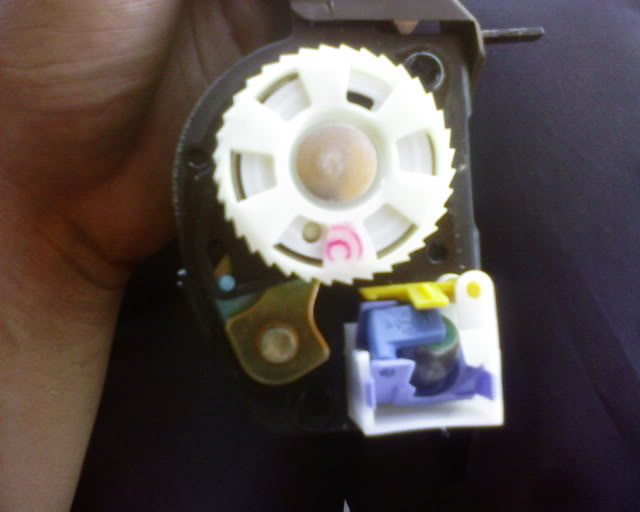

So i decided to take apart my 92 SR coupe's out and compare them:
Attachment 14935
turns out that the SR had been FIXED. It had a capacitor. so I saw what I had
to do to my other HUD.
The small capacitor, (can looking thing) on the top is the bad one.
Try and check it out in these pictures.
i know the pictures are blurry and ugly but its a cell phone picture and the
part is really small.here are the pictures:
BAD 93 COUPE'S
Attachment 14936
GOOD "ALREADY FIXED" ON 92 COUPE:
Attachment 14937
GOOD- THE ONE I FIXED MYSELF AFTER HOURS OF HEADACHES AND REAPTED ATTEMPTS TO SOLDER:
Attachment 14938

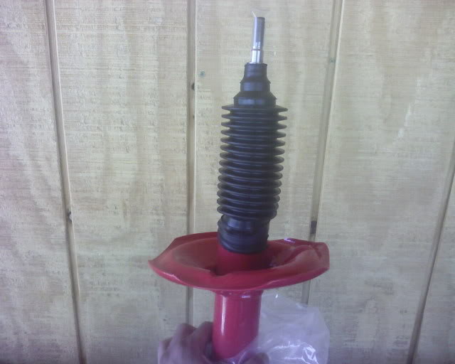

Installed these, kyb AGX, 3 days ago:
http://i293.photobucket.com/albums/m...n/SP_A1173.jpg
with these RS-R Down springs:
Attachment 14880

here is some old strut/shocks with old springs:
Attachment 14883
Attachment 14884

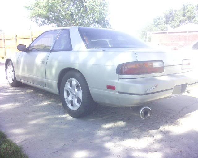

This is the next morning.
Lowered and front lip installed:
Attachment 14893
Attachment 14894
Attachment 14895

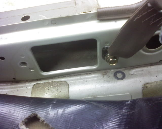

The rear seat belts stand at an angle. They were designed to work at an angle.
They have a little metal piece that holds it at an angel:
http://i293.photobucket.com/albums/m...n/SP_A1012.jpg
At first I wanted to keep it at an angle. Drilling a hole to hold the seat belt:
Attachment 14869
And a bigger hole for the bolt:
Attachment 14870
making it look like this. At the orginal angle:
and of coarse having to screw it on the top. There is a big bolt there that
hold down the automatic oem seatbelts.
Attachment 14871
and the other end screws in here:
where the lap seat belt went:
Attachment 14872
The problem is that you have to cut the rear interior quarter panel like this:
Attachment 14873
Attachment 14874

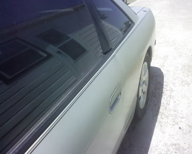

BUT it was a bad idea.
The seatbelts work fine but the interior rear quarter panel doesn't snap in
all around and would be pushed out by the bulky seat belts roller.
SO I DECIDED TO ALTER THIS:
http://i293.photobucket.com/albums/m...n/SP_A1111.jpg
IT CLEARLY STATES THAT IT SHOULD NOT BE OPENED.
IF YOU DON'T WANT TO ALTER IT DONT DO IT, I DID AND IT WORKED FOR ME.
this is what I did.
snap it open with a flat head screw driver.
Attachment 14875
study the mechanism.
this is what makes the seatbelts LOCK!
Attachment 14876
It has a little metal "barrel" looking thing that sits at an angle.
HINT HINT
when there is any movement or jerks it moves a little bit. Any little movement
locks it.
there is a little "finger" like extension that pushes the YELLOW ARM THAT LOCKS THE WHEEL.
THE FINGER LOOKING THING IS WHAT HAS TO BE ALTERED.
IF IT IS SHORTEN, THE ANGLE THAT THE SEAT BELTS HAVE TO STAND AT CHANGES A LITTLE BIT!
I used a little razor blade to shave about half of this FINGER like extension.
NOW it allows me to stand the seat belt up.
IT STILL LOCKS! IT JUST CHANGES THE SENSIBILITY AT WHICH IT LOCKS!
ANY SMALL JERK LOCKS THE WHEEL!!!
sorry for the caps but this is a very important issue.
Now you can installed them where seat belts were meant to be!

NOW then can be put in like this:
Attachment 14878
and look like this when trim peices are in:
notice that no alteration was needed on the bottom trim peices. and on the top a pillar
you have to drill a hole for the top part.
Attachment 14879

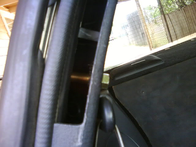

Good question. I considered using a spacer to clear the B pillar on the seat belts but decided I didn't need one.
Of coarse I used the longest bolt. It is on there tightly but not too tight to break the B pillar.
The seat belt holder thing can move, not freely but it moves if you move it. I also made sure that the bolt didn't turn with the seat belt holder.
There is not spacer. just empty space.
I'll post a pic of what you see through the gap (later).
Here is the picture:
Attachment 14663
