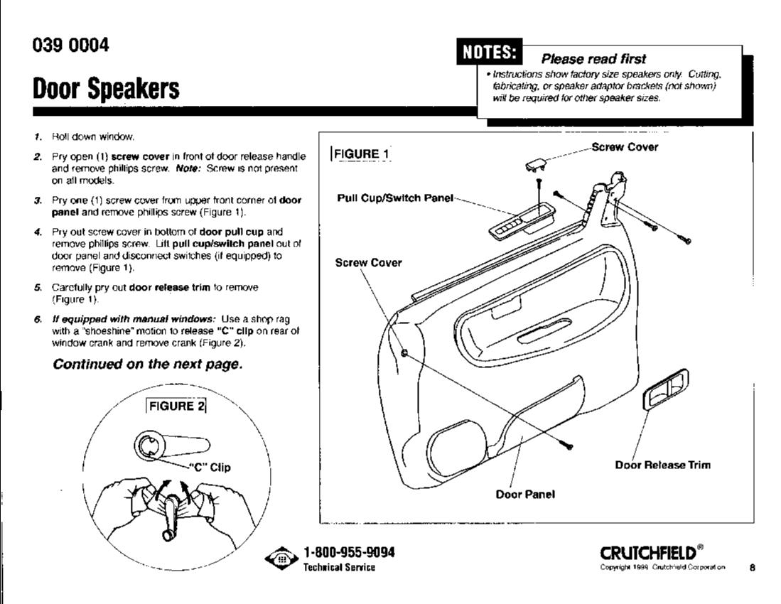

Whoever posted the cutchfield speaker diagrams, can you post them again if possible. They are very helpful and I would like to also use them ASAP. So if you can, either post them or send me an e-mail and I can post them.

I originally scanned them, but deleted them a while ago. I e-mailed them to AzzySK ask him if he still has them. If not I'll just rescan them for ya.

I got your PM so here you go. It says continued on next page, but you don't need that info since it's for convertables. Just do these steps then grab the panel from the bottom, pull, then lift since it hooks into the top of the door.
