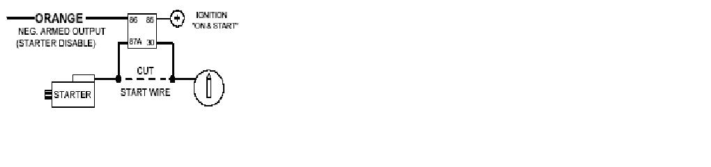

i got it all working except i cant get the damn started intrupt relay to work work right.
i cut the black/yellow wire and hooked it up according to the instructions and it doesnt matter if the alarm is armed or not the damn thing wont start. any help would be great.

after all that frustration and complications i called crutchfield and they sent me a new alarm cuz they couldnt pin point the problems i was having. i got the new one and its all working good. aperently i receieved a restocked alarm meaning some *** bag sent it back and they put it back on the self defective.
