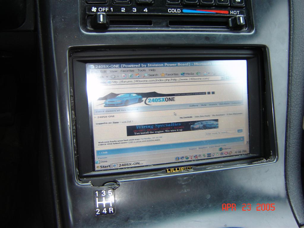

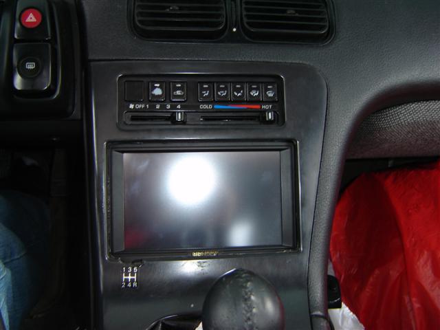

I had that screen in my 93 240sx, fit perfectly

Sorry, I don't have any pics anymore. Lost em in a combo of a pc reformat and cancelling the webspace I was hosting them on. There used to be a pic on here though.... Just searched for the thread, found it, it's about a year old... I linked to the pics on my webspace I had so they're gone :-/ There is 1 pic from another guys install though.
I scanned my pc but couldn't come up w/anything. Sorry. I don't have the setup any longer. I'm still trying to save up to rebuild my system.

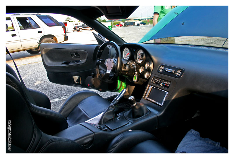

this is what i want mines to look like, this was shot at the nopi event at st. louis
and im going to end up fiberglassing... the whole dash.
