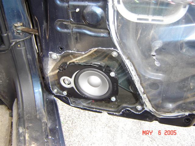

Goto home depot, buy a few lexan panels, trace out the speaker mounts that are in the doors now, cut (i used a dremel) and cut out a speaker hole for the size speaker you want. I'm using an infinity plate 4x6 speaker but in the future plan on putting in a 6.5" speaker more than like..
edit: once I finish up my wiring and such I'm getting some of the speaker baffles from crutchfield to help keep the speakers dry.
