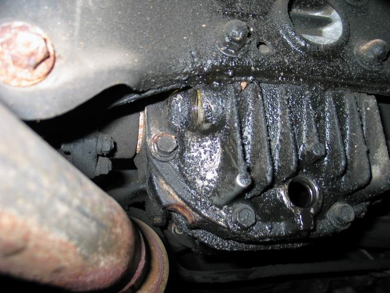

a picture of the drain (bottom) and fill (top left) plugs

Thanks Bumnah, I've never done a diff fluid change before (never kept a car long enough LOL) But yeah, this helps out a lot!
