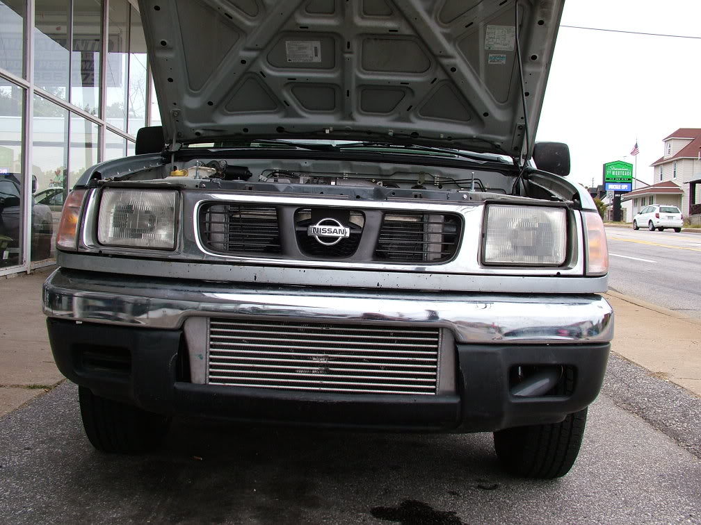

i couldnt get this from the orginal MA database as it crashed but here is the info and truck Brian build
And heres a quick lil vid.
http://www.vosko.net/media/mamotorsp...ruck%20009.avi
(p.s.- thanks Vosko!)
Its 98 Nissan Frontier originally equipped with the KA. WE made some custom mounts on the frame rails that utilizes stock 240sx motor mounts. We decided to do that so he can easily upgrade to an aftermarktet Cusco or Nismo motor mount.
Modified Trans Cross member
Custom 2 pc. driveshaft.
hammered trans tunnel
all factory gauges work... though the tach isnt accurate of course
We just need to build the exhaust for it and reassemble the interior shifter area.
I personally think its pretty neat... and a blast to drive. It rips the tires and its pretty much stock except exhaust and FMIC setup.
