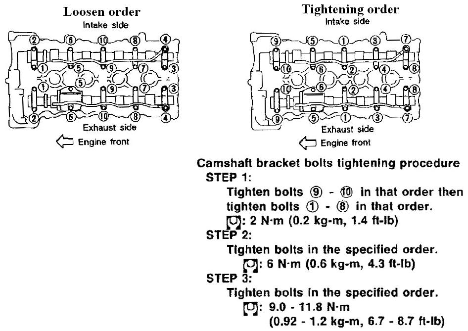

Old Jul 14, 2004 | 08:00 PM
I'm with Stupid's Avatar
Posts: 1,841
From: NY
Flywheel is 94 - 101 ft. lbs.
Pressure plate is 25 - 32 ft. lbs.
I can't help ya about the tensioner or sprockets but I have a chart for the rest of the cam procedure.
