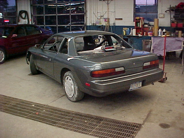

Here is a completed shot of the car
Old Jun 17, 2003 | 08:55 AM
  #28
dmn no glass? haha. Hope u have fun with the car
Old Jun 17, 2003 | 08:57 AM
  #29
jonpowell's Avatar
Posts: 609
From: Albany, NY
I pulled the glass to paint the car. Just gotta finish with a couple of trim pieces and the glass will go in tomorrow.
Old Jun 17, 2003 | 09:23 AM
  #30
haha cool, i thought the car didnt come with glass and u had to replace it or sumthin
