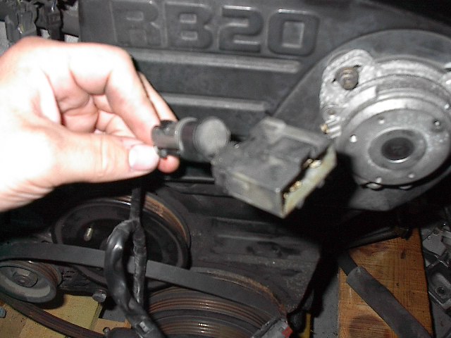

Here's the pics I got, 1st one is the plugs that sit next to the battery, 2nd one is the plug on the RB20 harness.
Thanks, Ryan

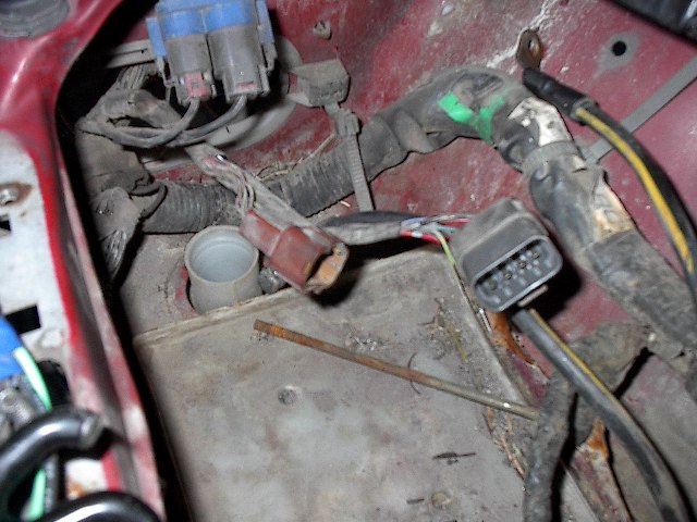

Old Jul 12, 2004 | 10:34 AM
rkcarguy's Avatar
Posts: 573
From: Washington State
2nd pic RB20 plug.

I believe that the red plug ont he car has the fuel pump wiwirng that should go to the ECU and the grey one right next to it has the switched power wires...the RB plug is the one that the switched power wires go to, if I remember right....there should be a black/red and possibly a solid red in the RB harness that would go to the matching wires in the gre KA plug. The black/pink wire in the redish plug goes directly to the black/pink wire on the ECU for the fuel pump relay ground.

Here's the colors I found on each plug.
RB20 Plug
White/Blk
Green/Orange
Black/Red
Lt. green
Lt. Blue
White/Purple
KA Chassis Plugs
Large Grey Plug
Red
Red/Black
Red/Blue
Green/Yellow
Blue
Black
Black/White
Small Red/Brown Plug
2 brown wires
Pink
Yellow/Blue
Green/Orange
Black/Pink
Black/Yellow

small red, the only wire that matters is black/pink
I am gonna have to look at my RB20 pinout I made and see what colors from that grey plug go to the red/black and red wires fromt he grey plug...later today I will figure it out for you.

I got it, went down to another shop that had a RB20 clip and tested the wires. 3 were constant +, one was switched +, 2 don't do anything and match up to the ECU pinout as A/C switch and P/S sensor.
