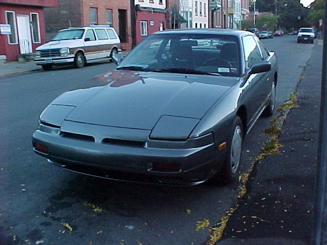

Just got the car done and it is a blast to drive. Here are some pics!

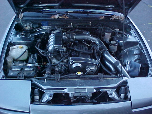

Another

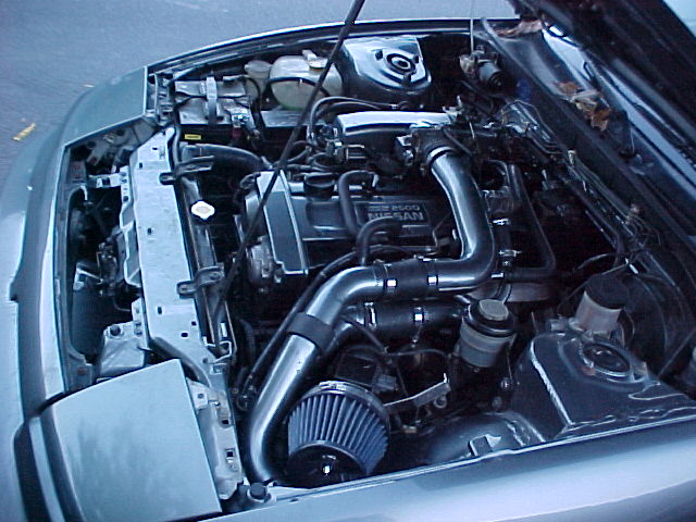

Another one

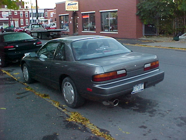

The last

hot dayum!! that heiffer looks clean!! mmmm, i smell a pignose sleeper! congrats, man.
Old Oct 13, 2003 | 02:14 PM
omg man...That is SOOO clean. Gatta be one of the cleanest RB25 240s ive ever seen Stock boost?
