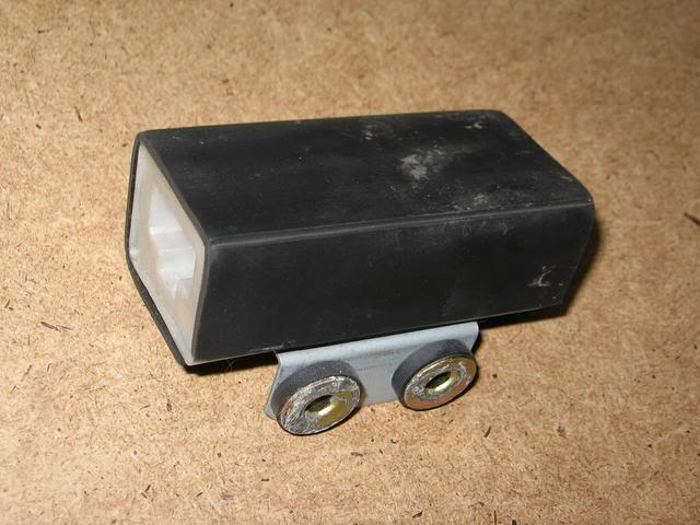

Old Apr 24, 2008 | 11:14 PM
its the black box, mine would work sometimes, then sometimes not..try smacking the black box to see if it changes anything, new one is like 30 bucks or something

Old Apr 25, 2008 | 07:30 AM
yea, looks like this

So, I took off my door panel, and made a couple more observations. When I try to open the window, the little black box mentioned above did not make any noise, but when I close the window, even when it is already closed, it clicks. I took the switch out, but didn't feel comfortable enough tearing it completely apart to see if there was a bad connection.
If that black box (an amp, I think it says?) isn't clicking, would that be a pretty solid piece of evidence that it is switch? Also, does anybody have a diagram of which pin(s) on the switch are for the down function?
Die Trying, I'm going to price a couple of these locally and at some junk yards tomorrow and sunday, but I might be interested in the switch you are selling. Do you know if it was working when you or your friend got it?

I had this exact same problem, replaced my power window amp and the problem was solved!

motegineon, where did you see the power window amp for around $30? I might be looking at the wrong part (not the motor), and it says it costs around $130...
Old May 6, 2008 | 09:11 PM
i duno bout brand new i found mine used
