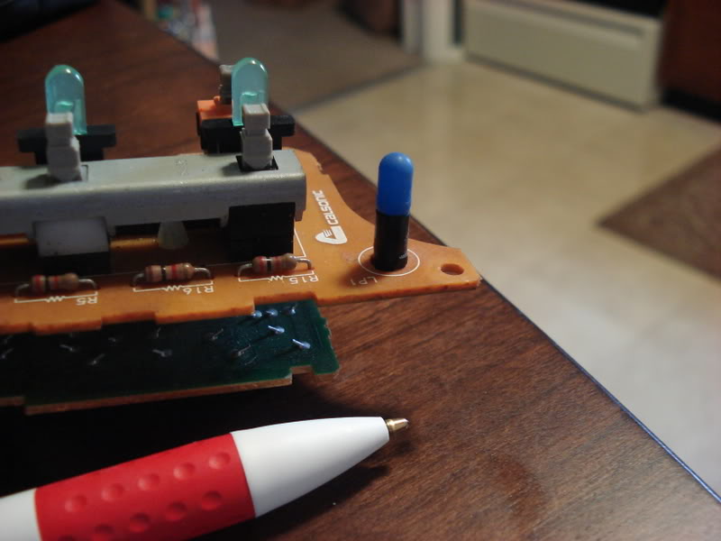

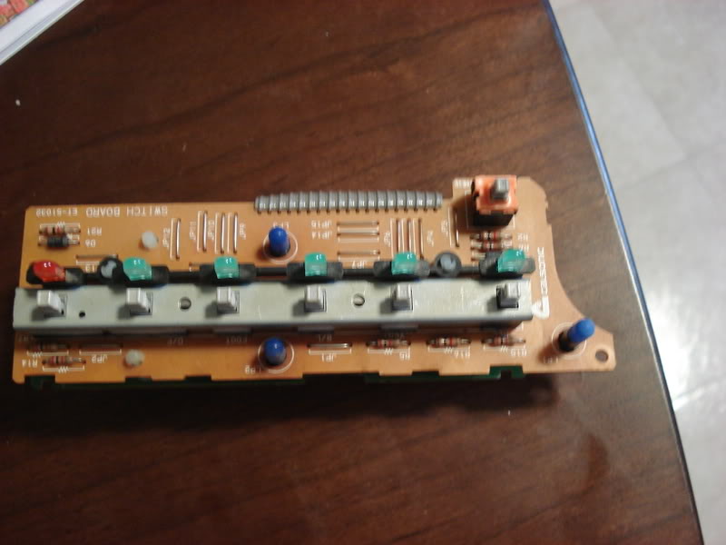

Hey everyone I'm trying to replace my burned out lights in my climate control and was wondering if anyone had done this before. I got the unit apart but I have no idea what size/kind of bulbs these are. I saw a write up for an s13 model but the lights appear to be very different. also I wouldn't mind going LED if possible. anybody have some information for me?
you can see the 3 blue bulbs in the picture. I thought maybe they were #74's like in the guage cluster but they actually are smaller then even that.

just to wrap up this thread, I did find the LED equivalents
its 3 of the little guys on the right called NEO3x's from superbrightleds.com
just a pop and twist deal. Unfortunately for those thinking of doing this, because the LED's are "directionly" lit bulbs they don't allow the light to be spread evenly throughout the controls so basically you have a bright spot in the middle with it fading towards the edges. oh well was worth a shot.

I'm sure if you popped them out and took them to the dealer they could figure it out for you. I decided to just keep the LED's so that it matches my guages, its not evenly lit, but it's better then what I had before.....nothing.
