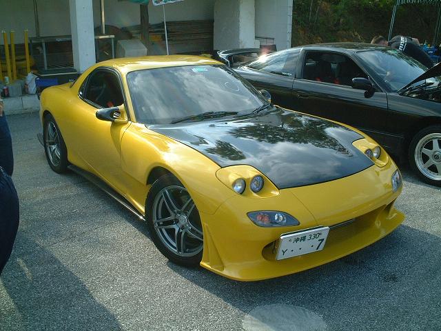

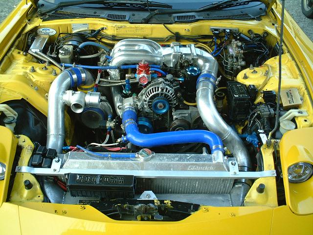

Here's a little Info on me...
My dad used to be on the engine building team for Richard Petty back in the early 70's when he race Mopar.. Threw out the 70’s and 80's he raced dirt track... I was born in 1971 and I was turning wrenches on bolts my dad would break loose for me when I was 5, I bought a 1974 Barracuda when I was 14 for $200 that had no engine, no transmission, no interior and no front end. I worked my *** off for the next 2 years and put the car together. Did all the body work, painted the car Hemi Orange and put together a 360 small block that put down around 400hp by my self with my own $ that I earned by working my *** off working in corn fields, tossing hay, walking bean fields and working in a Motorcycle shop building engines. I learned a lot from my dad and all the other racers. I took every shop class I could and spent damn near every study hall I had in the shop working on cars. I also bought a RX-3 for a $100 in 88' and started playing with rotary engines. In 1991 I joined the Army active duty and went to Germany for 3 years while there I spent my time also building Japanese Motorcycles and worked on countless cars to make extra $ to support my Paint Ball habit.. In 1994 I got stationed in Japan and started tuning Japanese cars. I was the first person in Okinawa to build a full tuned Honda CR-X that would walk 600 hp GT-R's in 3rd gear. Eventually I got tired of wheel spin and broken transmissions and I bought my FD in 1998. I'd always wanted one since they were introduced in the states in 1993. I now have around 30K in the car, 10K for the car when I bought it and 20K in parts. I do all the work myself and bought 80% of the parts by working on and tuning countless #'s of Nissans, Honda's and RX-7's. To be honest I hate working on Nissans and I refuse to touch a Toyota, but I'm thinking of picking up a 2JZ supra as a daily beater.
Basically everything I've ever built was done by me and done with $ I earned by working my *** off and researching in books and on the web. For this reason I can appreciate people who are trying to improve their car on a budget and I really love to smoke the **** out of rich kids with daddy bought and shop tuned cars. I'm also willing to teach and help others to do the same. I will give respect to the guy who lost the race to the shop-tuned car because he put his *** in to the car. That's just the way I am. If anyone on this forum needs help or has any question about anything I will try to help them or point them in the right direction if I'm not busy working on cars.
