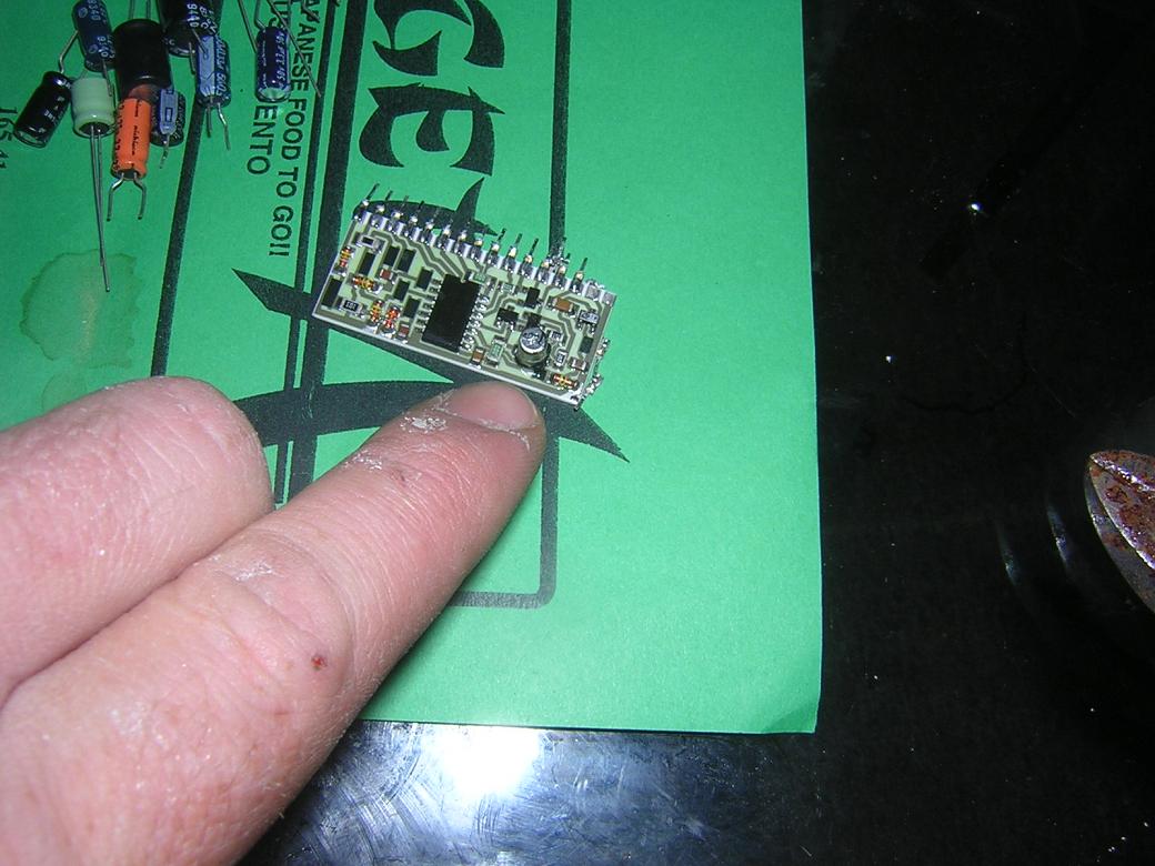

I guess mine went bad again I couldld find the right 1uF, and my .47uF was out also and so were 2 100uF's, everything on that board is pretty much 50volt....
I guess mine went bad again because I used a capacitor that goes into a audio passive crossover, it was a 1uF, 50volt straight through I probably just had the polarity wrong on the circuit board.
I'll leave pics of the work I did........Give me a sec.....

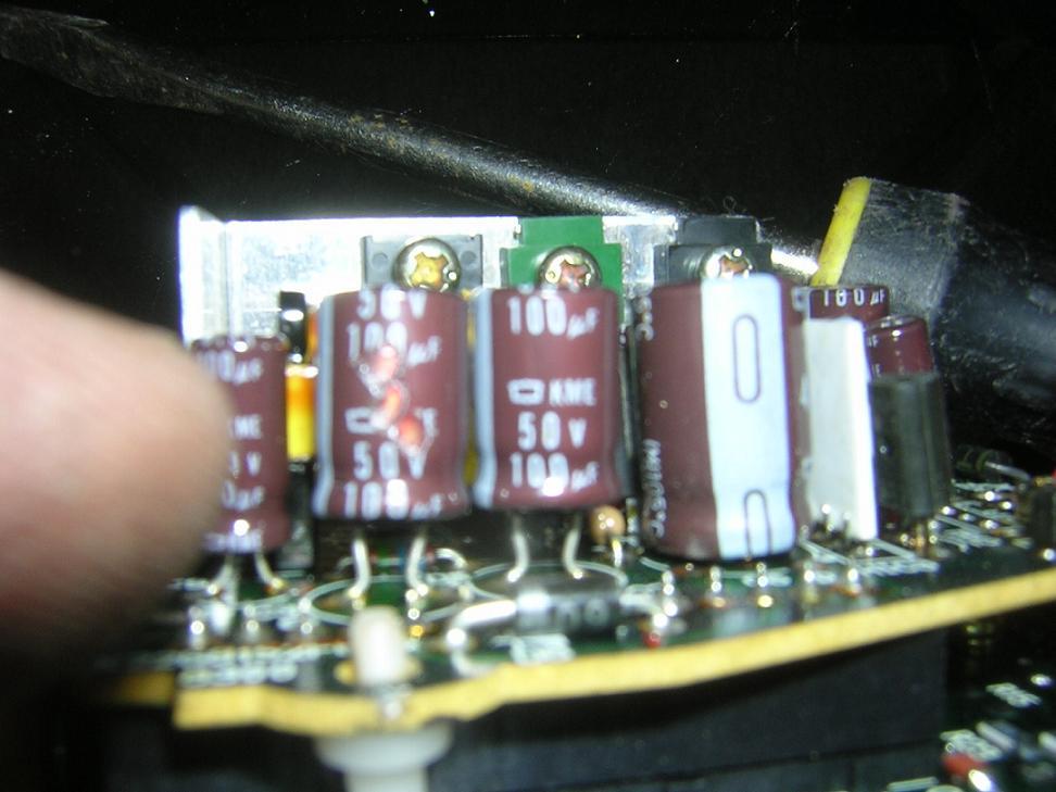

100uf, 50 volt are bad you can see in the pic that they fried......

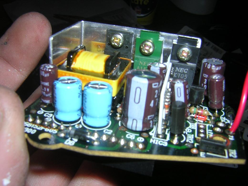

here are the new capacitors I installed

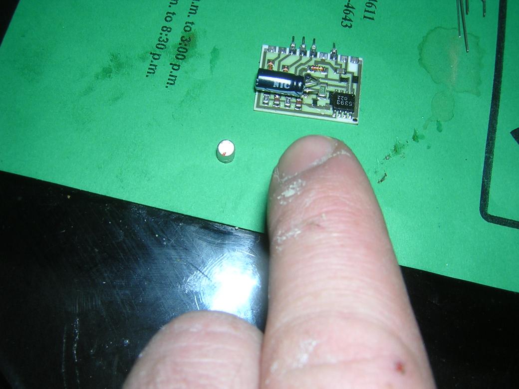

Another bad one

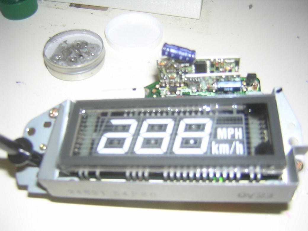

Fixed it!!!!!

This it what it looked like finished.........
