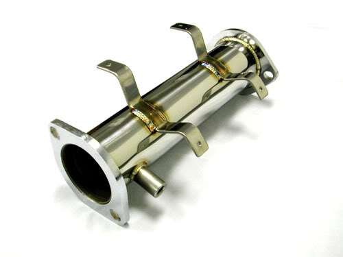

Can some tell what this is?
Old Oct 23, 2006 | 06:50 PM
DriftingTiger's Avatar
Posts: 25
From: Bakersfield, California
I know it's a test pipe, but whats that little pipe on the side for?

From: knoxville , tennessee
02 sensor I think
Old Oct 23, 2006 | 06:54 PM
Posts: 25
so what would you connect to it?
Old Oct 23, 2006 | 06:56 PM
sbanzer123's Avatar
Posts: 193
From: buffalo ny
egt gauge?
Old Oct 23, 2006 | 06:58 PM
thats really odd that the fitting is so long. any kind of o2 sensor would need to be alot further inside the piping. and it is most certainly not an egt gauge (they go on the exh manifold). plug it up
Old Oct 23, 2006 | 07:20 PM
i would imagine for tuning purposes to put a wideband into
Old Oct 23, 2006 | 07:48 PM
a wideband sensor needs to be directly in the flow of the exhaust, as i said before that fitting is too long to stick any type of o2 sensor in.

haha that little pipe is starting to bug me lol, but anyways what would you plug it up with?
Old Oct 23, 2006 | 08:08 PM
what pitch is it?
im sure like a flywheel bolt or something would work. if it's standard, take it to homedepot and get a plug. you could cut it shorter and use it as a wideband if the threads go all the way through the tube
Old Oct 24, 2006 | 04:27 AM
I have pretty much that same test pipe and that bung is plugged up with a bolt. Just Home Depot it.

It's a built in defouler. A lot of aftermarket test pipes and dp's have them now a days. It's there to deter or limit the amount of exhaust flow to the o2 sensor. Therfore, tricking the computer into thinking there is still a catalyst on the car. It' for the secondary or post cat. o2.
Old Oct 26, 2006 | 07:50 AM
good observation ^ you can also get a resistor or wire in an o2 simulator (what i did)
