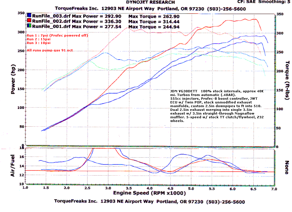

I thought people might want to see comparisons in dyno results between the VG, and the SR. The SR remarkably can compete very well, and I thought people wanted to see some dyno result's.
Also people in another general forum thread are crying that an SR or VG turbo set up, won't beat a Ford Cobra mustang, BOY did I prove those winer's WRONG......LOL
Dan Flowers s13(sr20det with boosting "all stock trim" WHPower: 260whp/ Torque: 283ft-lbs ): 0-60: unknown, 1/4 mile: 13.2 @ 104mph....
http://www.horsepowerfreaks.com/view...Silvia~~~.html
Lum's 71Datsun510 VG30dett(JWT ecu,SAFC,filter, WHPower 336.3, Max Torque 314.4): 0-60 UNKNOWN, 1/4mile 12.871 @113.69mph
www.datsuns.com/red/index.htm

^wtf was up with the profec...292whp with it off @ 7psi, but with it on @ 10 psi it only pulled 277whp???

Dunno I am assuming it was a throttle correction made with the SAFC. It was just probably the throttle correction, and intercooling.
