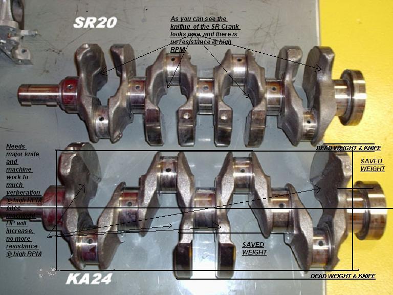

Example of knife and counterweighting
Old Jan 28, 2005 | 07:32 PM
BigVinnie's Avatar
Posts: 2,502
From: Walnut Creek
Thought you guys might want to know the differences in the KA and SR cranks. Both are great cranks, but the KA needs some work. I took this pic from Joel07 of the 200sx forums, gotta give credit where credit is do, but I laid out the geometry pattern.
Attached Thumbnails Example of knife and counterweighting-counter-weighing-ka-crank-refined-pic.jpg
