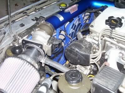

Finally took the time to install my FAL electric fan and thermostatic switch on Saturday. Overall easy install but a serious pain in the but, not to mention I started cleaning the radiator which was filled with news paper and debris.
A couple of reasons why I did this install.
First reason I wanted more low end torque at the wheels and this was a good way to do it.
Secondly my fan/clutch assembly took a major crap on me. It was so bad my idle would fluctuate really bad.
Third I could start to notice the drag and power loss from a clutch fan that no longer works good.
Fourth reason is that it is getting time to replace the upper timing chain assembly of it's rattle and it's an SOB having to put crappy parts like the belt driven fan back on.
Fifth reason I'm heading out to infinion for the 1/4mile, so what the hell might as well.
Do I notice a significant difference? yes!!!!!!!! I also have the thermostatic switch clocked in to the temperatures and fan speed that I need it at so it does the job and is worth every penny!!!!!
Things that sucked were that I had to cut the old clutch fan assembly apart just so I could bolt the water pump pulley back on.
Another thing that sucked was that I dragged major but and it was dark by 8PM and didn't finish the wiring until about 9:50 and I still had to test and adjust the thermostatic switch. Major pain in the rear when it's dark outside.
But it's done so I thought I would show some pics of the finished product.

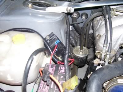

It's also super easy to have your thermo switch as close to the relay/fuse box as possible as I show in the last pick. You can route the ignition wire in directly through the 30AMP fuse. It's also closer to the radiator and easier to run the temp sensor lines to the switch as well.

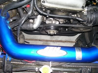

Jack front of the car up about 1 foot or until you can crawl underneath.Remove intake system. Move vacuum lines out of the way if you have any.
Then crack the nuts from the fan/coolant pump pulley. Then loosen power steering pump.
Pull the belt driven fan/clutch out. Then take the 4 bolts off of the fan shroud ( 2 at the bottom corners, and 2 at the top corners). Fan shroud and if you have A/C electric fan will come right out together as 2 separate pieces.
For the coolant pulley pump you will need to cut the clutch fan off so that you can use the 4 hole pattern as a large washer to tighten the coolant pulley back on. Then you can tighten the power steering assembly and belt tight once that is done.
Remove coolant lines to remove radiator (top and bottom).
Minor modification will be needed around the coolant passages (inlet/outlet). If you are still using the stock OEM radiator.
You will have to completely take the radiator out. Clean it before positioning and mounting the FAL fan (it's nice to work on a table while doing this).
When positioning the fan you will notice that there is very little clearance for the coolant hoses and straps to go back on to the radiator. Just simply cut out some of the black rubber on the FAL fan, where it will look where the coolant hoses and straps may touch the rubber. There will be some aluminum strapping in the rubber, so cut away with shears or bend it back, it will be very brittle. Once the fan is perfectly square and positioned with the radiator then you use the 6 threaded type (vinyl) screws with vinyl nut and washer. Take the 6 vinyl screw threads and put them through the radiator core (first you will need to use a pick to plunge a nice size hole through the core without damaging it). The FAL manual shows you how to prep the heater core to get the plastic threads through, and tighten with nut and washer.
Once the electric fan is locked into the radiator then mount back into place onto the radiator support, and re attach coolant lines.
As far as electrical goes follow the FAL instructions they are very direct when it comes in the mail. You will just want to put it close to the relay fuse box as I did.
