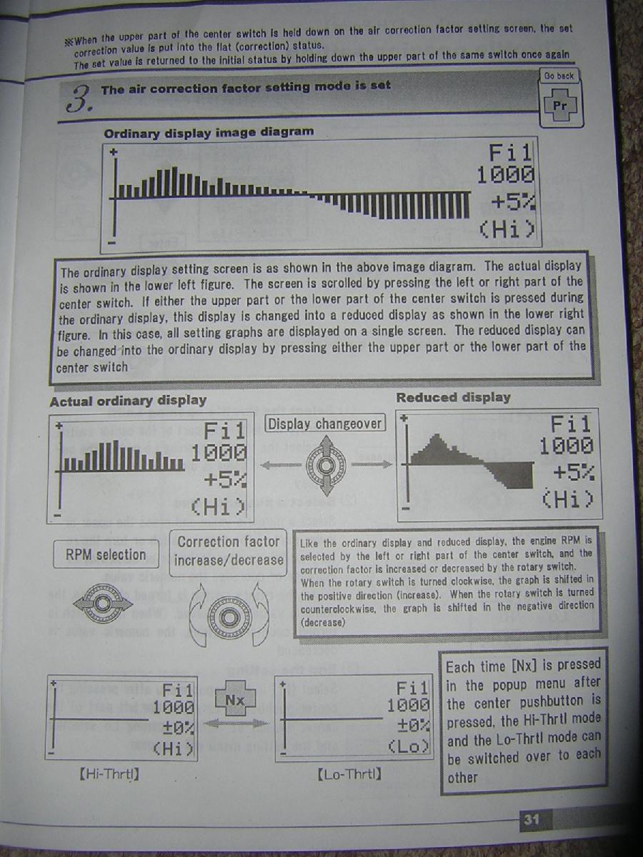

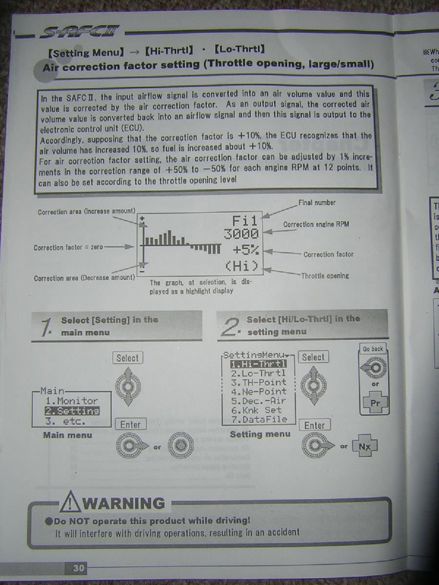

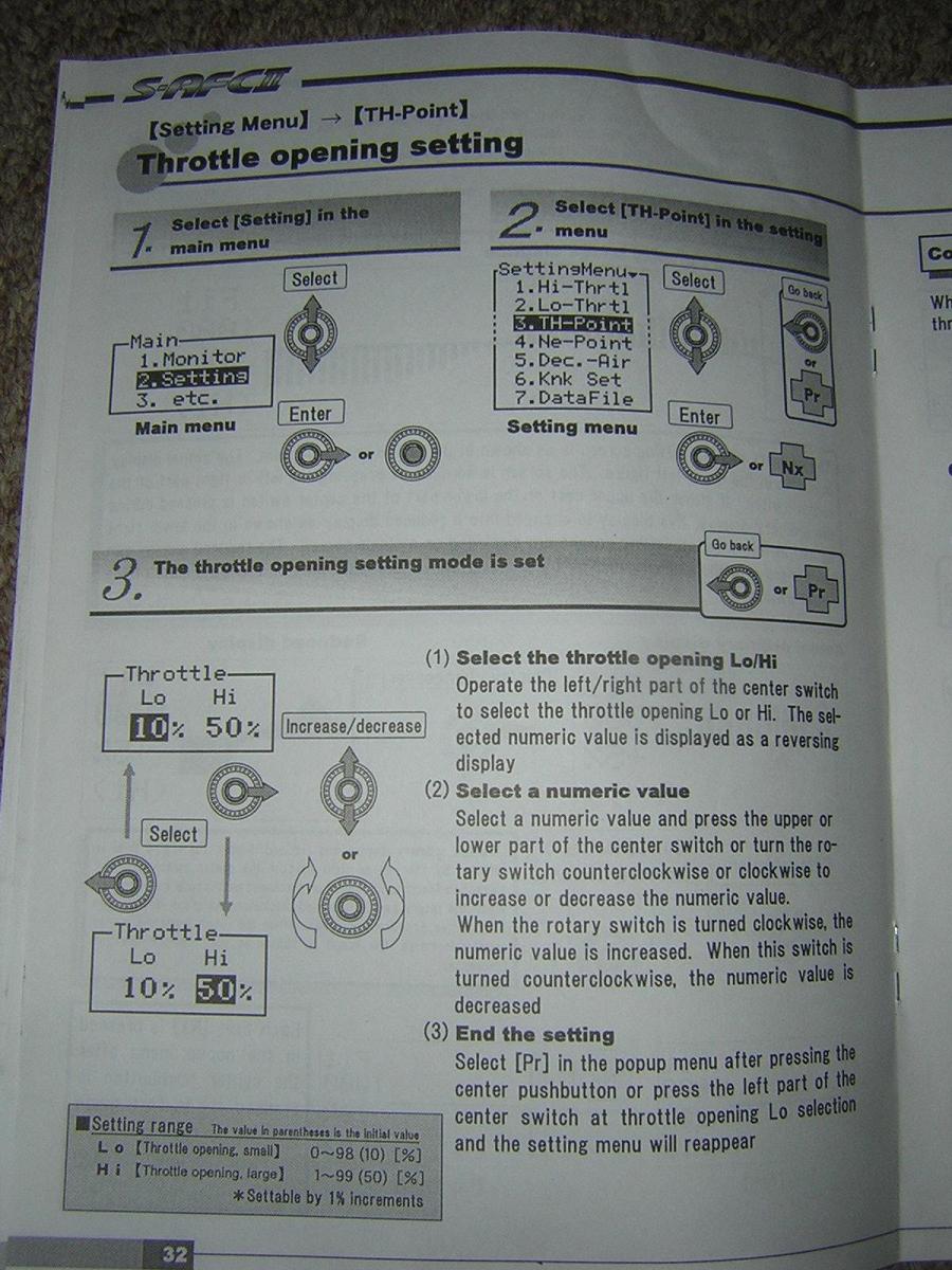

Just so you get a better understandin of the APEXI SAFC I have taken pictures of the throttle correction pages if you need more info let me know..........
Old Apr 12, 2005 | 12:25 PM
BigVinnie's Avatar
Posts: 2,502
From: Walnut Creek
Page 1 SAFC thottle correction.............................
Attached Thumbnails Looking at high resistance and low resistance injectors which one's are better?-picture-068.jpg
Old Apr 12, 2005 | 12:26 PM
BigVinnie's Avatar
Posts: 2,502
From: Walnut Creek
Page 2 SAFC throttle correction....................
Attached Thumbnails Looking at high resistance and low resistance injectors which one's are better?-page-2.jpg
Old Apr 12, 2005 | 12:38 PM
BigVinnie's Avatar
Posts: 2,502
From: Walnut Creek
Page 3...............
Attached Thumbnails Looking at high resistance and low resistance injectors which one's are better?-page-3.jpg
