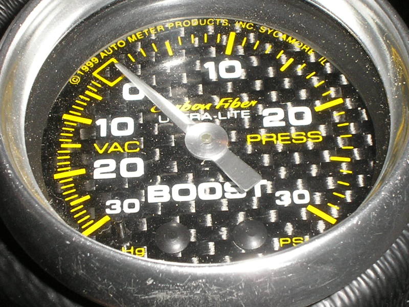

Check it out. New stuff courtesy of eBay and teh Brown Santa!... mmm CF goodness. This should give you a hitof what im doing with the 240.

Im gonna replace the oil gauge with a water temp gauge. The oil press gauge will go under the radio...

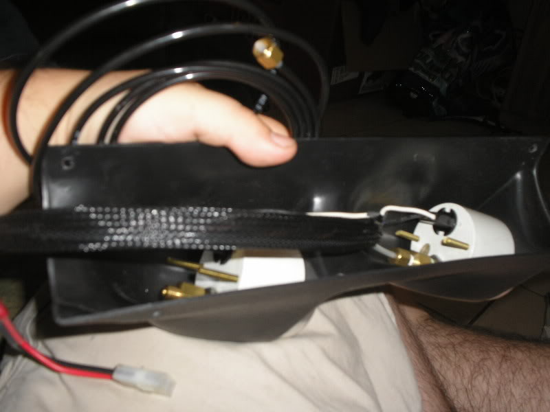

i got a question about the guage pod that goe on the pillar, does it mount over the stock on or completley replace it, cause my 95 has the little tweeters in there and i like them lol, just curiouse. thanks

... it goes on top of the pillar. Actaully, its short enough to have room to play with on either end, depending on how you mount it. The person i bought it from didnt send the hose for the oil gauge though, which sucks. Where would i tap into the motor for that anyways? Yeah the brown santa = UPS. Some sexy gauges if i do say so myself. I WAS going to go NA, but i cant pass up a local deal on an sr blacktop... 1200.

youll need a mechanical oil pressure sender. replace the stock oil pressure switch or you can get a y fitting to fit both stock and your new gauge. its 1/8th bspt but the sender will prob be npt. the switch is next to the oil filter. gl.

, thanks, thats exacly what i wanted to know.
