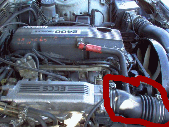

well i'm going to check my timing today by gettin the number 1 piston to tdc and looking at the rotor. hopefully that will tell me something. could a crack in this piece do it too. their was some duck tape over it when i bought it i thought it was protecting a crack so i was going to replace it anyway so i didn't even bother removing the tape since it ran fine with it there. (the pic is from another car)
