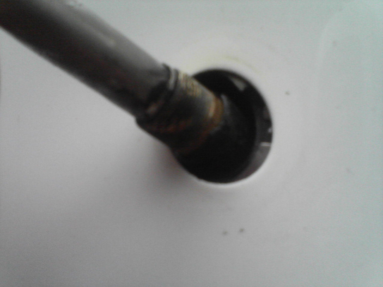

you know i was thinking of that too but i dont know how. where is the motor? cuase i pulled apart the inside paneling to look for it but i dont see it anywhere.
Heres a picture ( sorry about the blurriness) so you have an idea what im working with. its all warped from when i tried using vice grips to yank it out!

the motor is inside the back, but hidden behind some metal on the driver's side. it is akward. how did u manage to get the initial piece with the two holes on top loose. the ones that are exposed. i tried a lot of things but it is really on there. any suggestions for tools would be great.

motor is behind the ****ty emergency jack, better pull out the side carpet lining too, might be a few other things holding it up.
