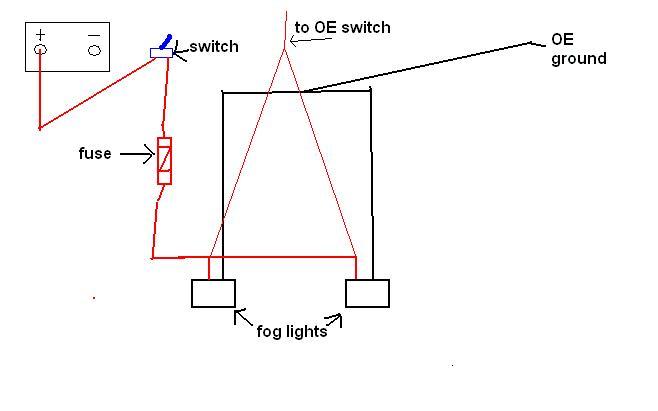

you basicly just run a positive wire to the + of your fog light (don't cut the oe one) just splice it. i'll make a quick sketch...
Old Apr 21, 2004 | 04:30 AM
LTSCUDRFT's Avatar
Posts: 426
From: Near Halifax NS
here it is

take a 12awg wire get some splicing tools run the wire from your batt. through the firewall to a switch then from the switch to a fuse then from the fuse to the fog lights.
