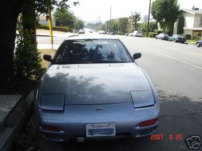

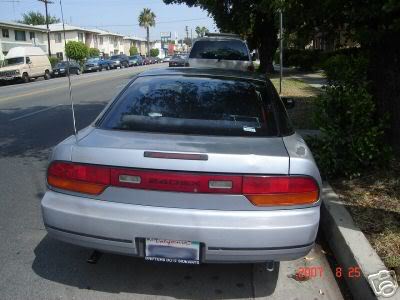

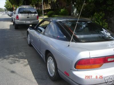

u think itz 2 high?? .. i got a few picz of the car...here the link tell me wat u think plz.. i would really love to get this car .. thankz
http://cgi.ebay.com/ebaymotors/ws/eB...m=270159145347

Hmmmm, that actually does look clean. Is that a paint imperfection on the 2nd picture on the right quarter panel? And also on the rear wheel well in the first picture? Otherwise, that car IS clean. I would maybe pay 2500.

That 240 needs some work, I can already tell. First off, the clearcoat is fading. Paint isn't cheap. Knock some cash off of the price. She's riding on steelies with teardrop hubs. Knock some more cash off. How is the interior? Faded? Cracked? Missing altogether? How is the car mechanically? Have you test driven it? 145k miles, though low by comparison for its age, is still kinda high. Do the headlights work? Do they make noise going up or down? Has it been wrecked? Any records of maintenance? Anything visibly wrong under the hood? Cracked vacuum lines? Half-assed repairs? How is the suspension? Worn bushings? Worn struts? How are the tires? Will the owner let you do a compression check? Does the A/C work?
You see where I'm going here.
240s are known for a few things
1- Rust
2- Electrical issues
3- Simple, yet time consuming motor repairs
4- Worn suspension/bushings, namely the TC rods and rear subframe bushings
5- People who don't know crap about cars doing half *** repairs before you guy it.
Good luck mang.
