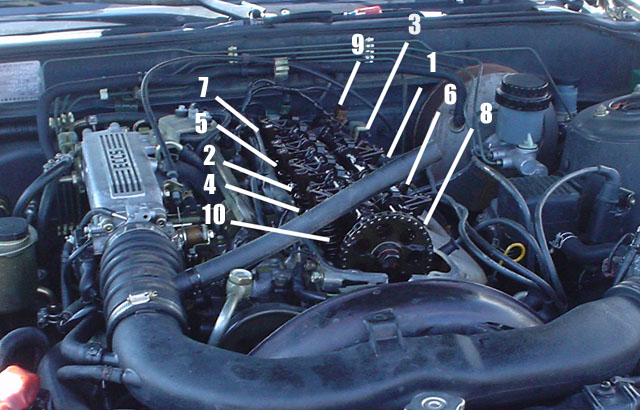

I am replacing a head gasket on a KA24E and needed to know if anyone knows what the head to block blots are supposed to be torque'd down to?

According to the service manual:
Tighten all bolts in numerical order to 22 ft. lbs. Then tighten all bolts to 58 ft lbs. Loosen all bolts completely. Tighten all bolts to 22 ft. lbs. again, then tighten all to 54-61 ft. lbs. Always loosen and tighten bolts in numerical order.
Tightening sequence shown.
-adam
