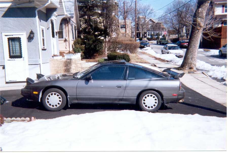

I will walk the car with a digital camara and even make a video running the car and all... Not a spot of rust, or any damage.... Staten Island NY car.. If you want it we can talk price and look up shipping...
