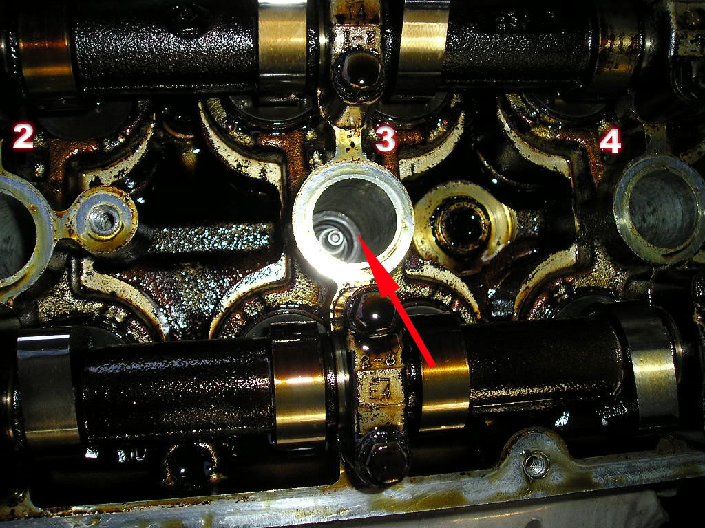

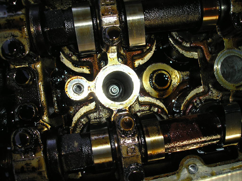

Any idea what these rings are?
Cyl #1 and #3 have them slipped up so I cant get the plugs out. Looks like #1 (the smashed one) might be my problem?

hehe, i notice that you still have your top timing chain guide on there, TAKE THAT OFF ASAP. anyways cylinder one plug definately looks stuck, have you tried taking it out with a spark plug socket? not sure what those rings are but seems like that is where the spark plugs threads on to. maybe previous owner or you didn't tighten the spark plugs in correctly and it messed it all up? have you tried a power balance test? a compression test wont be good if you can't take out all the spark plugs.
It is the rubber end of your spark plug boot, get a hook tool and pull it out. you said that u smelled gas really bad? if so it could be one of your fuel injectors are bad. thats what it sounds like to me.
lawls... yup, bosch spark plug wires are notorious for that... 2 of mine are like that too...
well to help you with your question... this is what i know about your situation.
First start off by pulling the rubber boots from around the spark plugs and ckeck them out one by one. look for any wierd coloration or damage. also, are you smelling gas from the exhaust or is it under the hood. If one of the cylinders is dead (i.e. isnt igniting, or is igniting but burning poorly) the excess gas will pass through the exhuast. I cleaned the motor on my 240 the other day and accidentally got some water in the front spark plug (cylinder 1) hole, so every once in a while, it wouldnt fire... sounded just like a gokart, and had very little power... and on top of that, yes it did smell like gas was leaking from the tailpipe.
An engine needs 3 basic things to run: Fuel, Fire, and compression. Your air/gas mixture is the fuel, spark is the fire, and compression is self explanatory.
Check the compression in each cylinder, once you determine if it IS getting compression, check to see if it is getting spark. Once you know it is getting both compression and spark, the only problem left would be fuel...pull out the injector on the dead cylinder and check it to see if it is firing or not... it may just be really dirsty, or leaking. There are other less common but equally serious problems out there, and this only scratches the surface. Good luck

Thanks for the advice guys. Sure enough my plug wires 1 and 3 are missing the bottom part. I bought new plugs and will go buy wires tomorrow. Hope this works, this 95 corolla is starting to **** me off.
