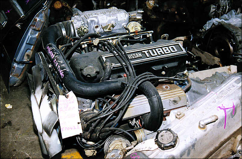

Also found out for the ultimate destroker high rev of up to 9000+ RPM you can import what is called the NAPS-Z 1.8et " NO IT"S NOT A CA18DE". Basically the KA head will bolt to the 1.8 giving a really high compression for high rev, believe it comes with the NAPS/KA stroker crank and assembly.......
Since it comes with a turbo that won't work for the DE you can sell the turbo to a buddy that has a KA24e..........

OOOPS forgot to leave the pic...........

Well when you destroke your raising compression, what I need to R&D is to find out the dish size of that NAPS-Z piston. NAPS-Z engines usually ran a compression of 8.3 or 8.5. Installing the KA head will obviously change the compression ratio.......
The point was that honda killer wanted to destroke for higher rev and "eventually turbo".....
If the compression is to high you can always get a thicker gasket to drop the compression for turbo......
But with a 1.8 stroker crank engine you will run more torque than a d or b series honda engine......... Possibly more torque than the sr also, at 1.8 it could high rev more than 2.0litres.........
