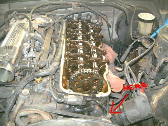

what about the belts in the front. How do I remove those. It tells me I have to remove them in my factory service manual but doesnt tell or show me how.
Old Oct 20, 2004 | 01:22 PM
LTSCUDRFT's Avatar
Posts: 426
From: Near Halifax NS
you have to loosen the bolt at the top (1st pic) and the 3 in the second pic.

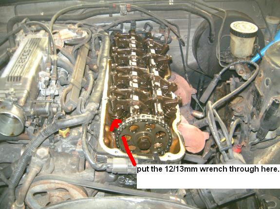

It also says in my book that I need a "pulley holder" to hold the camshaft in place so I can take off the bolt to get the sprocket off.
1st: you will need an impact gun to remove the bolt that holds the crank pully on, because it is not going to come off by a hand tool.
2nd: the is no tool to do what you said.
3rd: just like you said "Timing Gear Puller" Great for servicing crankshaft pulleys (when you have the bolt off)
4th: for the cam sprocket (not a pully) stick a 12/13mm spanner wrench in the closest one of the holes towards the bottom on the left side of the sporcket (see attachment) and use a 24mm spanner wrench to remove it.
