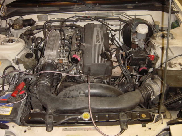

I did feel a little bit of an increase with the aem. Love it and the sound of it. The reasons I am trying this is i'm going to get some nismo headers and it seams like everything on that side is going to be pretty hot air wise... Plus you get the MAFS closer to the throttle body. I will post a picture or two once my batteries charge.
I am however concerned about heat as as it is set up now the radiatior hose rests on top of the aluminum short intake and heat it up real hot. Have to find a way to insulate that or drop the pipe lower and remove the battery plate. Does anyone know if the same hole is under that plate as on the drivers side? I don't want to remove it for no reason.
Pictures:
This is a close up of the improvised intake. I have added metal screen wrapped around the radiatior hose to help dicipate heat.
Here is where the battery now resides.
An overall image.

[QUOTE]Originally posted by Fast1One
That filter looks awfly close to the body. Wont it get damaged with the movement of the engine? I hope that battery is secured well...Otherwize, Nice work

The filter is very close at this point. It hasn't moved enough (or has enough movement space) to damage it at all even through a bit of tough driving. Even with that said I do plan to take it to a machine shop and see if I can get a pipe bent with a little better angle to cut below the radiatior hose and hopefully loose about an inch in length for a better fit. And from what I can see the space does look open under the battery tray.
The battery is in there pretty good. You can't move it with your hands but If I decide to leave it this way I will put in a hole for a battery tie down clamp.

cowboy turbo the best way to run the positive battery cable is through a grommet in the passenger side wheel well... if you remove your inner fender and look back you will see the rubber plug with wires comming out of it... you can easly run a cable through there and into the car... i dont advise you run a ground cable as that can cause some electrical noise...ground the stock negative battery cable to the frame... and then make a new ground cable in the trunk...
same with you tanshin... shorten the ground cable... as long as it is grounded to the frame it will work... the extra long ground cable can cause what is known as a ground loop and give you noise that you can hear in your stereo,,, and can cause all kinds of electrical gremlins to pop up... but nice work all in all...
