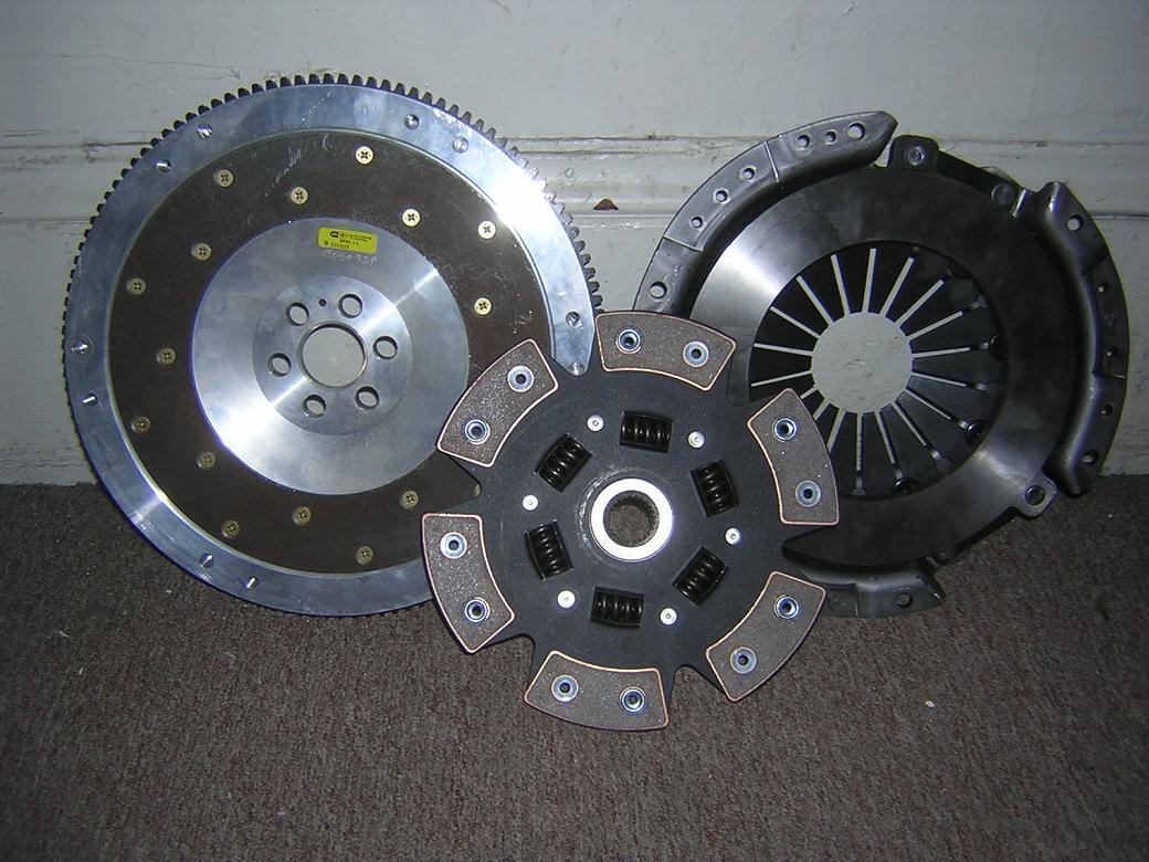

Personally I have the Fidanza aluminum flywheel, K&N intake, stage 2 clutch "compitition brand".
At higher RPM I can defenitly feel more power in the HP curve.
I was going to get a pulley, but without a dampener I have refused to purchase a pulley that will shorten the life of my engine.
If you are going to purchsae an aluminum flywheel you should consider a stge 2 clutch kit. You will need the additional gripping force needed since the torque, and HP degredation has been removed by about almost 13lb.s. My rear wheel's defenitly wan't to rip up the VLSD alot easier.
I personally would go with a Header,High flow cat, Aluminum fly wheel, cheap $15 EBAY FILTER, and a stage 2 clutch.... This would be a great stage 1 starter kit, the aluminum flywheel allows the engine to ASPIRATE much "EASIER".....
