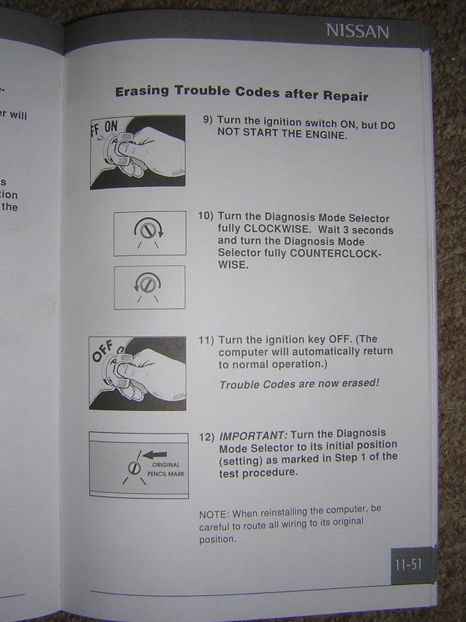

UUUHHHHHHHHHHHH this is how you reset the ECU propelly.......
Damn Raine I either thought you died or was making sweet music with Drift Girl......LOL

oohhh, see i did that but i didnt wait 3 seconds. i think as soon as i got it fully turned i waited for a whole second and turned it back. ill try it again when i get home. thanks guys!
