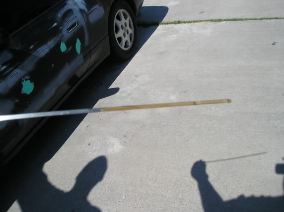

Chocolate milk, nature's lubricant!
Gotta check the Chocolate Milk level in my crankcase. Look, its full.

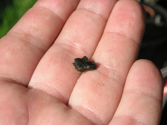

A wonderful thing to find on your upper timing cover....

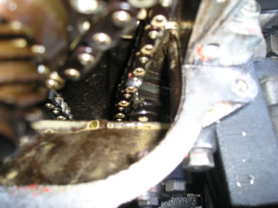

And for my final trick, the amazing disappearing timing chain guide act!
Now you see it...
Presto Change-o!!!
Now its gone!
...noisy bastard

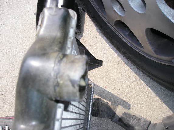

Okay Bigvin, i got everything from the radiator to the water pump off of the motor. I have a question though. Do the alternator PS pump and A/C compressor have to come off too? If so, how should i go about doing it? I have a few more items to add to my list of parts i need.
A Radiator, cuz mine looks like this:
And also, i found that my lower tensioner ISNT bad...*sigh*... As i went to pull off the water pump pulley, i decided to try to turn the motor clockwise (facing the motor) and watch the tensioner... as i turned it, it came out and put tension on the chain. ****. So why did my chain eat through the guide? Have i run it so hard that the chain stretched THAT much? im really lost on this one.
