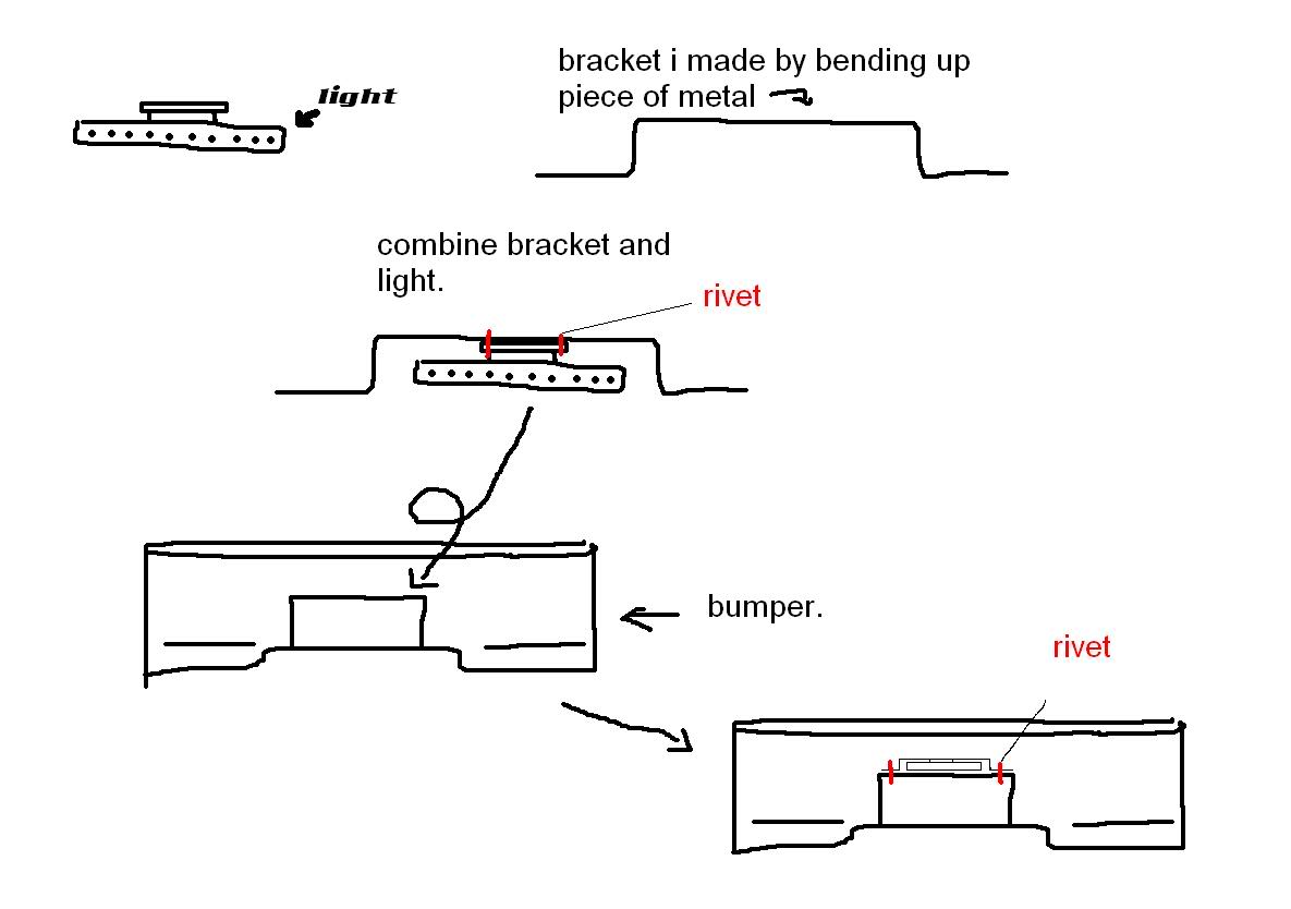

  #873

  #875
Originally Posted by motegineon
hey whatd u do for the license plate light? i dont even have one and got *****ed at the other day by a popo so i figure ill get it hella bright like urs
i stuck an LED fog light up in there.
Old Apr 6, 2008 | 08:30 PM
  #876
damn, aight and just wired it to the wiring that was already there?
Old Apr 6, 2008 | 08:38 PM
  #877
urmyhero4now's Avatar
Posts: 173
From: San Jose, Ca
yea its just two wires just splice them....i have something like this similar to yutas
http://www.autobarn.net/20-735.html?site=google_base
Old Apr 6, 2008 | 08:58 PM
  #878
man that ish is fancy...i dont drive no q45...***in baller.
Old Apr 6, 2008 | 09:02 PM
  #879
Posts: 173
From: San Jose, Ca
AAHHAHA....its cheap and it gets the job done bro. do it up they have blue or white...both are dope no matter what u get...but my suggestion would be to make two strips of flat metal and drill two holes in them one on each end to mount the light higher into your bumper so all you see is the light on your license plate...not the bar itself.

yea well see, i might just rig somethin up for now since im hella broke status

i got mine for $11 at autozone...it has like 12 leds or something like that....for that price your gonna be paying more to build one then to just get the one from a pepboys or something....but when you start making led boards you let me kno...we need to talk.

Yuta comes thru with the beautiful diagrams yet again!
Oh btw Yuta, not sure if cops gave you any gripe about thoe license plate lights, but they have to be either white or I think yellow... or was it red? White for sure, I think yellow is the other one.
Old Apr 6, 2008 | 11:52 PM
  #885
mine are technically "white". the high exposure on henry's camera makes it look blueish.
