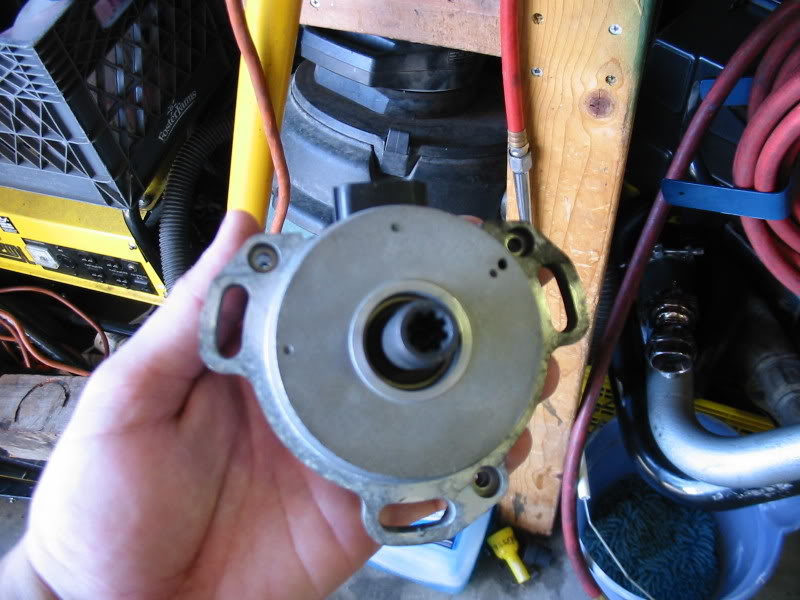

scratch that.....temp sensor didnt do anything....but i keep finding problems for example
this guy....i can hardly spin that spindle on my cas with my hand...XD
on the other hand the timing belt and water pump look ok

YOKATTA!!!!!! so my car runs right.... the crank angle sensor was the problem.. heres a quick vid of how it sounds with the turbo elbow and downpipe.
