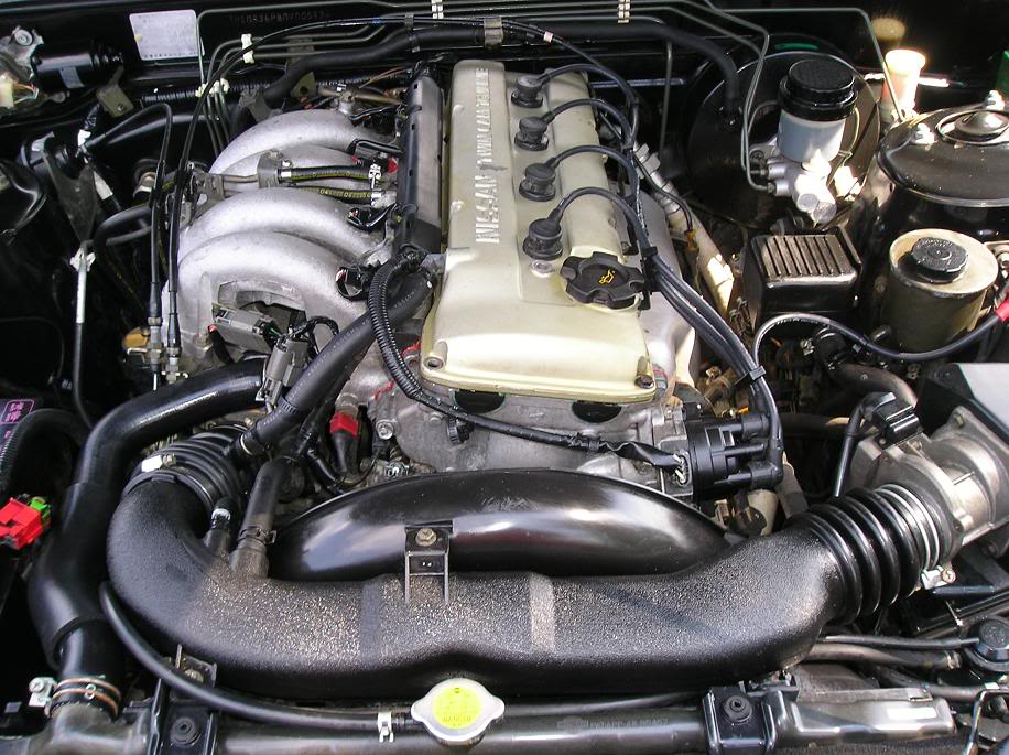

No, i didnt die for those of you who wonder. My dad ganked my computer cuz my room wuz filthy. Dont worry, ive got some souveniers for you guys. My 240 has undergone some big changes since its days in my yard.
For instance, the engine bay before,

And after... Check out the texture on the paint, its jsut perfect! Ill tell you guys what i used if you want.

I'd like to know what you used. That looks beautiful by the way.

Yeah, it looks bad ***, one of the best paint jobs for a valve cover I've seen so far. Looks like flat black, Hi-Temp, multi layered right? I want to know what you used!
It looks pretty smooth and even. Good job!

Well the black was Duplicolor's "Low gloss black" engine enamel. Its between gloss and flat. kinda like Satin black. It has ceramic in it so its not goin anywhere. The lettering i did by hand with a brush and paper cup with duplicolor's "aluminum" engine enamel. The black has probably 3 coats. Took me 2 days to finish. The first time i painted it, the letters peeled because i tried to tape them off before painting it black, but it didnt work. So i took it back to work and sand blasted it and now thats it.
