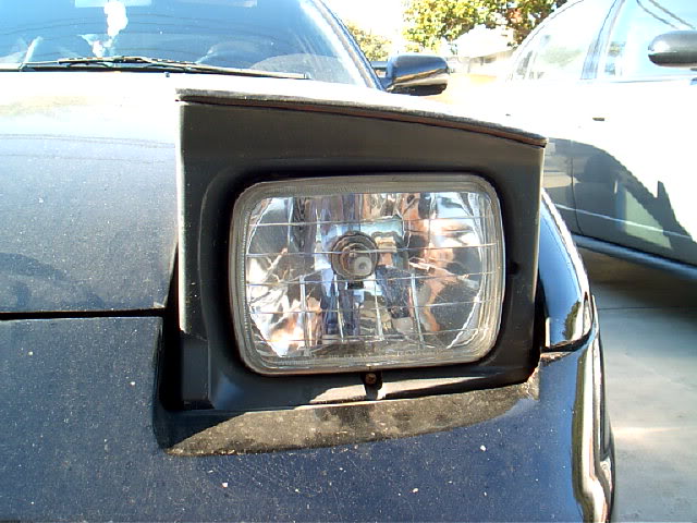

Yeah, hold on, give me a min and I'll have them up.
EDIT:
It's 14mm tall and 20mm wide. What Ive always wanted to do was retrofit a projector and have a small light illuminate the area surrounding the projector sicne a big square with a small light up circle would look kind of wierd.

Those Look very simple to do a retrofit. How much clearance is there between the back of the housing and the body of the car?

not much. i retroed acura mdx projectors into an EBAY clear conversion (not on ebay anymore) i believe the mdx's are 6 inches deep or so. i had to cut hte back of the flip up housing and the bulb ignitor (audi gen 3) hit's the radiator support. it's hard to aim. i'm looking into doing a fixed headlight conversion now but it is much better than stock. it's just that you can barely aim it. without the view finder on the mdx projectors i wouldn't light up any roadsigns. ... let me put it this way... when i parked my car on an incline facing up the incline and walked to the top of the hill... i wasn't blinded. it's that low, but it works for now. i am afraid of going over 90 at night though.

well i coule make it so that you can adjust the projector by its self. but i do not know how much room you have to get behind the headlights and adjust them
on the S14's it would be much much easier
