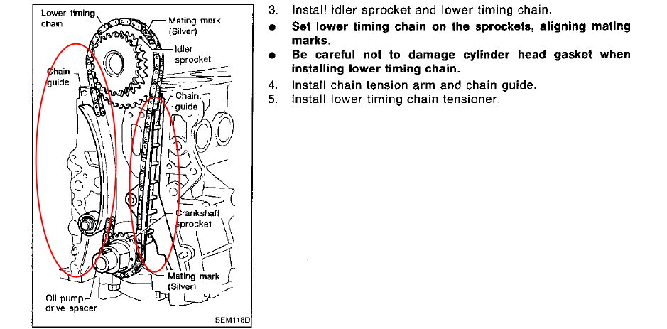

I see that one but I am talking about the ones in the lower cover, not the upper cover. Still take them off?
Old Jan 12, 2009 | 04:24 PM
yes this one...
it can be removed also.
if you are talking about the guides at the bottom don't touch those

Yeah, I am talking about the lower guides at the bottom, they are cracked and need to be replaced so I am going to replace them with new ones, I planned on leaving the ones out that are up top. Also, the head gasket ripped one side in half when I was removing the lower cover, I was going to just put some good Nissan gasket maker on it and put it back on there, do you think it will be ok? I don't see why not because there is no real pressure on that part of the head gasket but I just want to be sure. Thanks!
Old Jan 12, 2009 | 05:01 PM
yea that is fine.. i did that before , i just allowed the gasket maker to harden for a hour.
