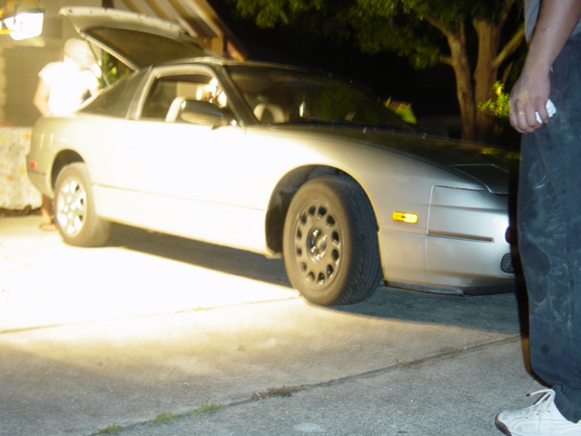

ok, so i helped chuki funk put his cut springs on, took a little while because of cheap *** tools...and spring compressor, we ended up not even using the spring compressor and played it dangerous. heres a pic of the front drop. you gotta scrutinize it a little bit to really notice the drop, but its there.

Old Jun 29, 2003 | 09:42 PM
ANOTHER_240sx's Avatar
Posts: 19
From: tampa ,fl
yea i was gonna cut my springs decided not to im just getting the same set up jonas has....kyb agx's,groundcontrols........o yea jonas car went in the body shop ill bring it over when its done but i have to see you b4 then to get the parts i need...

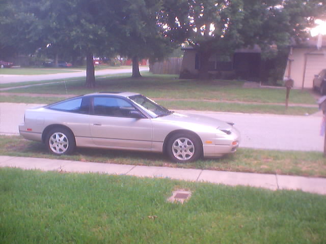

i only cut the front sprins, and it does handle better... its coo
struts were blown already... and its not bouncy at all its firm
heres a pic
not a real big difference.. about 1.75inch drop

Old Jul 17, 2003 | 12:51 AM
  #30
s14.5boy's Avatar
Posts: 673
From: sactown bitch
Well it looks nice
