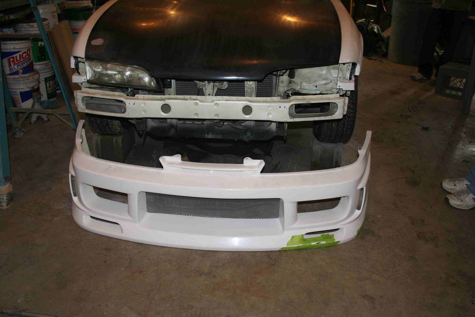

My front bumper is sticking out 1 inch too far and its 2 inches too far down any help?

What happens is when we put the bumper on the bumper support it fits in fine but its not in the right place an inch too far out and 2 too far down

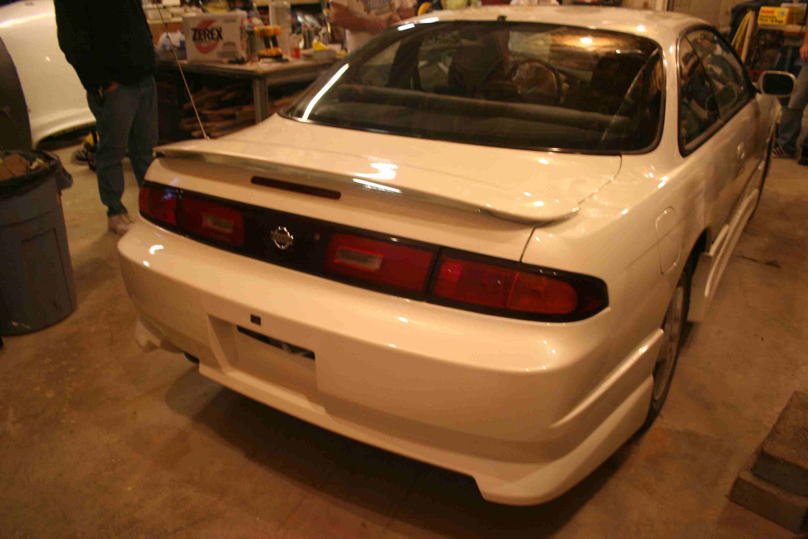

240sx_Racerx's Avatar
Joined: Oct 2005
Posts: 15

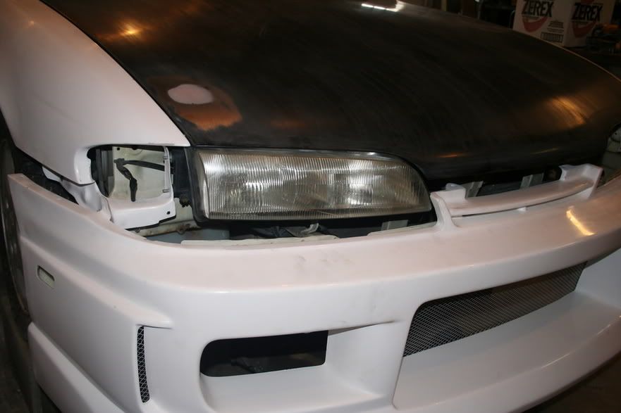

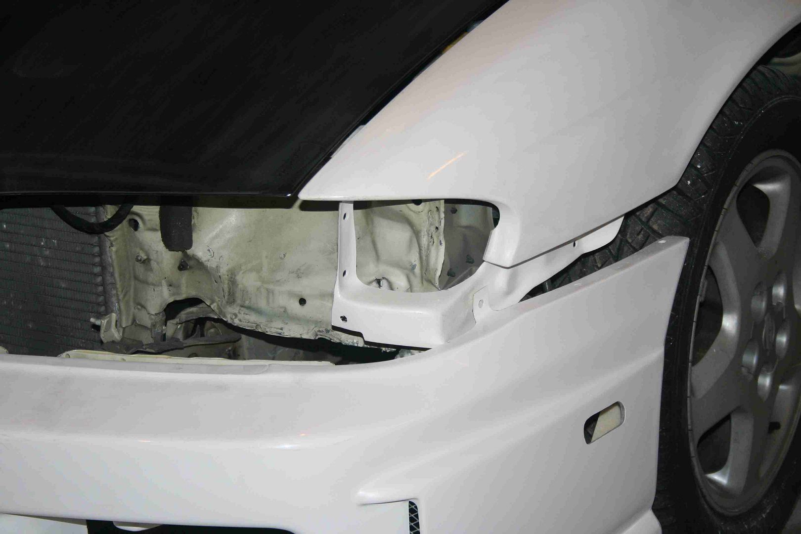

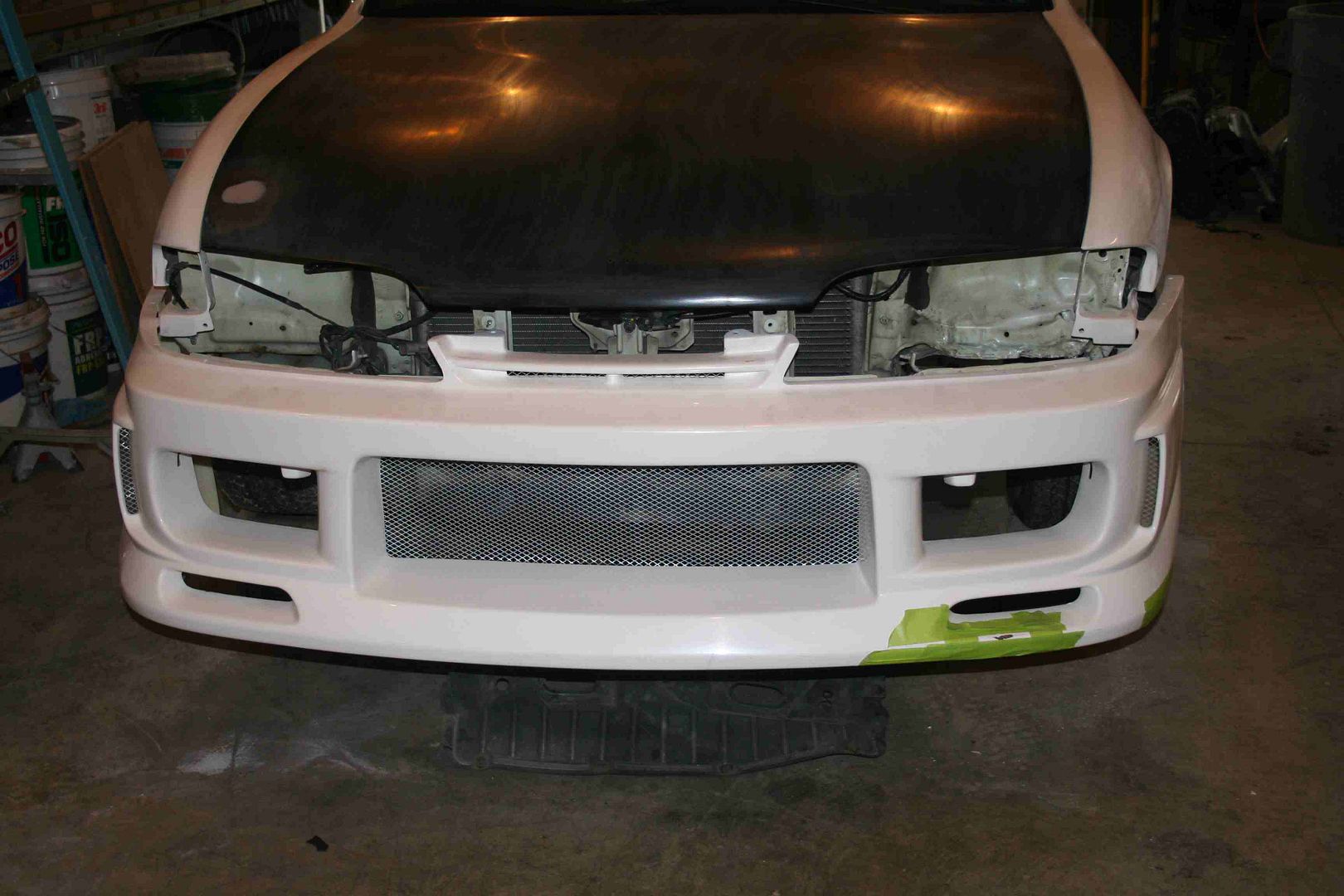

no its a chargespeed but we worked it out, we cut off the bumper support and the cut the bars an inch and moved it up 2 and welded it back on. So its done except for headlight,turn signal,airbag, and my cat-back exhaust system needs to be put in. Here are the pics!
