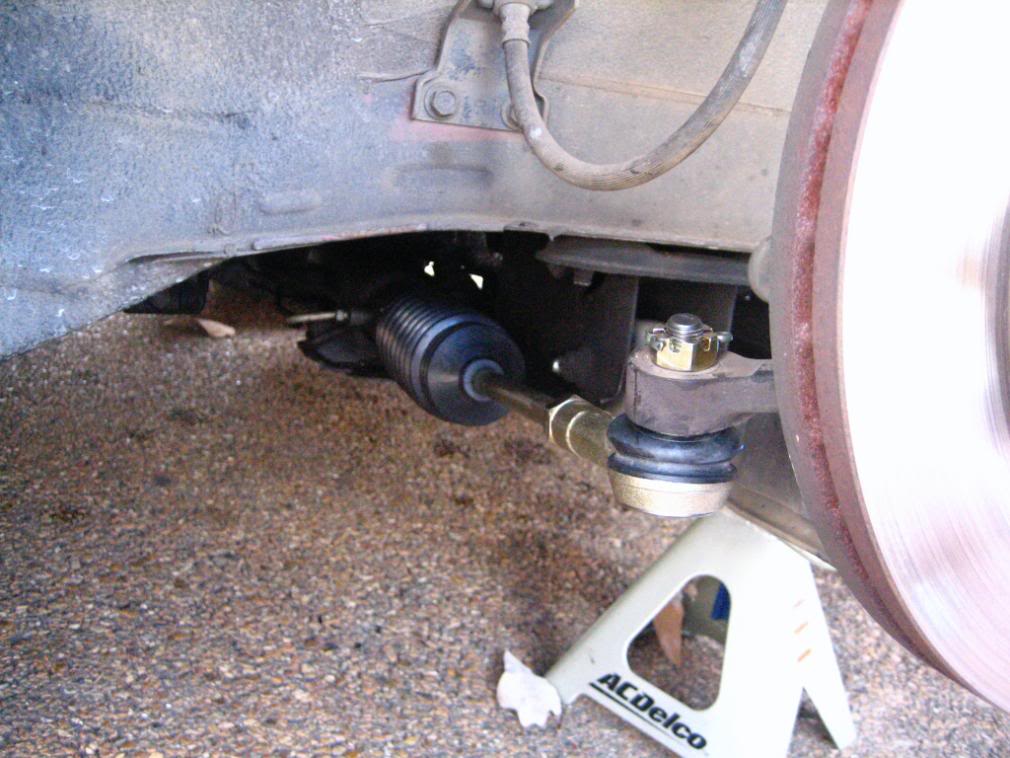

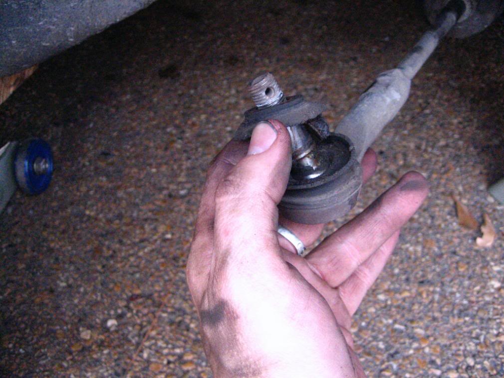

alright all u picture ******
drivers side here
cleaned up a bit

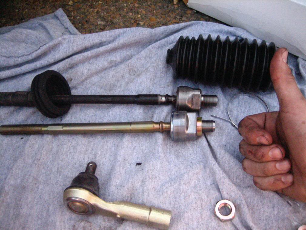

comparison, teins arent a whole lot bigger, but they are much more rigid, notice the angle spacer
i keep even my boots real...ok i didnt care i bought the cheapest ones i could find lolzlesauce

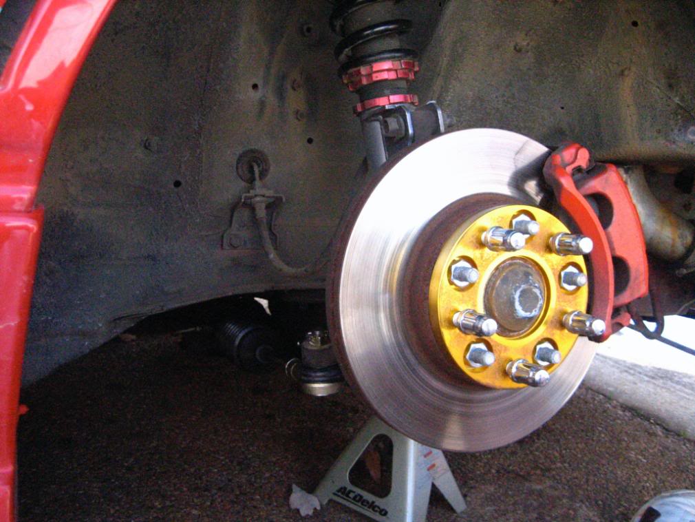

flush like a toilet ladies!
but wait theres more

pics do not do justice of angle increase, i highly recommend if not replacing your whole tie rod setup, to atleast do the angle spacers and better end
oh and if ur lower like me, buy the adjustable endlinks (height adjustable) to better fix bumpsteer..i would have but i got this setup for pretty cheap so i figured this was way better than the 20yr old stock ones
overall the steering is much smoother and responsive, and the turning radius feels amazing..

looks good bud, may have to get some washers.! lol

I just put tie-rods on my car today.. i need an alignment baddddd.
did you keep that clip that is on the steer shaft? the one that you had to chisel off? And how did you get that knuckle that screws in on the steering shaft tight? wrench it?
Old Feb 25, 2008 | 10:32 PM
  #195
no i didnt keep it because you dont use it if you use the steering angle spacers, just make sure to use lock tight
and yea i had a 12'' crescent wrench and just cranked them as tight as possible
