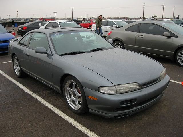

So now that I have FINALLY saved up enough money to buy a house (18 months and 18 grand later) I can finally start putting money back into the car :) If anyone remembers I said a long time ago I had decided to build a autox car to SCCA's ST class. I hate it when most people are "followers" and and just run all the same car in one class (which for ST is the 89-91 Civic Si) so I wanted to show people that there is a car out there that can beat it, and after much research I decided to do the 240sx was the car to do it with. After I bought the car and started doing some more research I found out that a guy named Jason Rhodes has already build an awesome ST classed '93 240sx and beat every civic Si out there and won nationals back in 2005 (so this isn't exactly uncharted waters).
My goal is to do a "budget build" spending less than 9k (including the price of the car) with this 1995 240sx SE.
If you are curious as to Autox ST class rules (or any other class rules) here is a link to the rules book (St class starts on page 68 of the book):
http://cms.scca.com/documents/Solo_R...Solo_Rules.pdf
While I don't have the budget he does (he put 14k into his $4k car) I'd like to build something close to the competitive level of his, and do the divisional events in San Diego, CA and and Farmington, NM. I don't think I will have the free time or the funds to do the national championship in Nebraska :(
Here is the earliest pic I have of the car, I bought it for $3,600 with some slight front end damage. had to hammer out the passenger side front corner a bit, and replace the passenger side fender, headlight, and front bumper. I also put on a stock spoiler (I prefer the stock look on most if not all cars, just lower it and call it good ;) )
Unfortunately this is the earliest pic I have of the car:
Attachment 10590
As you can see in that pic the first thing I bought were some Drag Dr-17 wheels (they weigh 17.0 lbs each, and were simply what I could afford at the time, I'd REALLY like to get some Kosei T1 KS's, only 14.1lbs each!)wrapped in 225/45-17 Dunlop Z1 Star Spec tires (if you want the best performance tire, Dunlop Star Specs or Kumho XS's are the tires to get)
Since I can't stand a 3-color car (car is maroon, replacement carts were green, spoiler was white) the first thing I did after wheels and tires was paint. I choose "smoked Metallic Grey" for the color and I am very happy with it :). Also the car even came with some no name coilovers so that is what is on there now.
Pics:
http://http://i483.photobucket.com/a...6/100_0211.jpg
Attachment 10591
Attachment 10592
Attachment 10593
The car also has an intake I built myself along with a lightweight racing battery:
Attachment 10594
I had to paint the engine bay and trunk myself, which was A LOT of work, here are the after pics:(I know the trunk looks kinda bad, but its just the shadows, it looks a lot better in person)
Attachment 10595
Attachment 10596
I just installed a stock VLSD (per ST class rules) so I am anxious to see how it performs at the next event July 26th & 27th.
I hope to make this a build thread and show my progress over the next year or so on building a great dedicated autox car.
