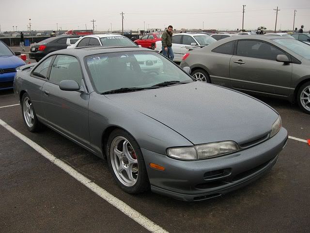

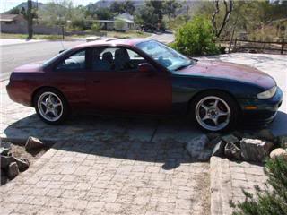

Here is the earliest pic I have of the car, I bought it for $3,600 with some slight front end damage. had to hammer out the passenger side front corner a bit, and replace the passenger side fender, headlight, and front bumper. I also put on a stock spoiler (I prefer the stock look on most if not all cars, just lower it and call it good )
Unfortunately this is the earliest pic I have of the car:
As you can see in that pic the first thing I bought were some Drag Dr-17 wheels (they weigh 17.0 lbs each, and were simply what I could afford at the time, I'd REALLY like to get some Kosei T1 KS's, only 14.1lbs each!)wrapped in 225/45-17 Dunlop Z1 Star Spec tires (if you want the best performance tire, Dunlop Star Specs or Kumho XS's are the tires to get)

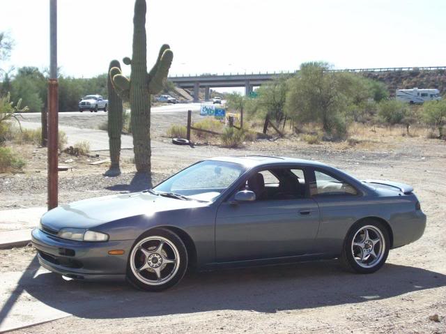

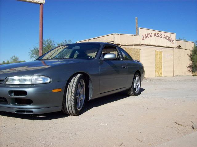

Since I can't stand a 3-color car (car is maroon, replacement carts were green, spoiler was white) the first thing I did after wheels and tires was paint. I choose "smoked Metallic Grey" for the color and I am very happy with it . Also the car even came with some no name coilovers so that is what is on there now.

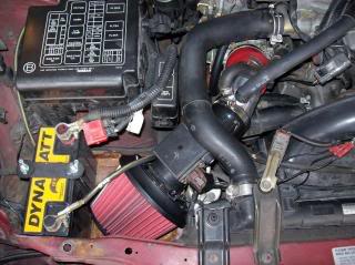

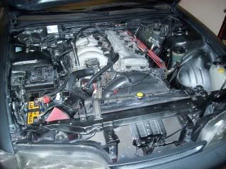

The car also has an intake I built myself along with a lightweight racing battery:

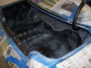

I had to paint the engine bay and trunk myself, which was A LOT of work, here are the after picsI know the trunk looks kinda bad, but its just the shadows, it looks a lot better in person)

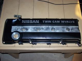

Ok, it took a lot of taping off and filing, but here is the new valve cover, I'm pretty happy with the results
