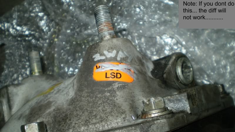

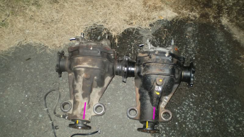

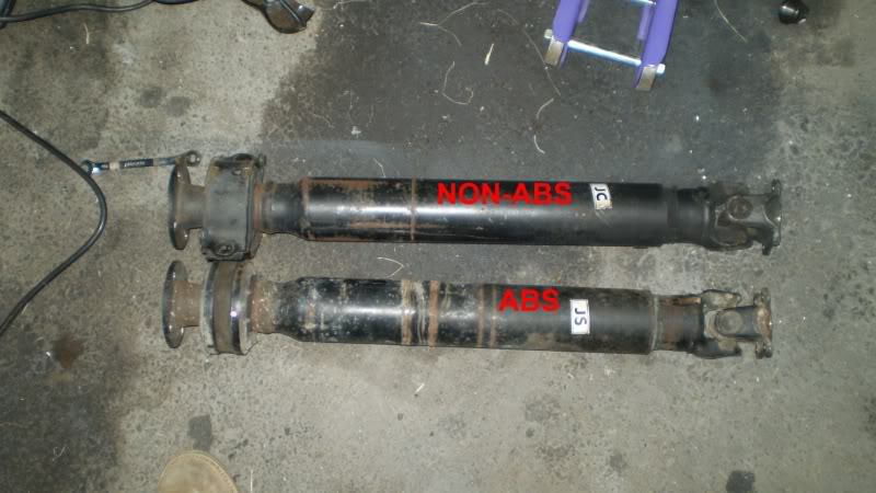

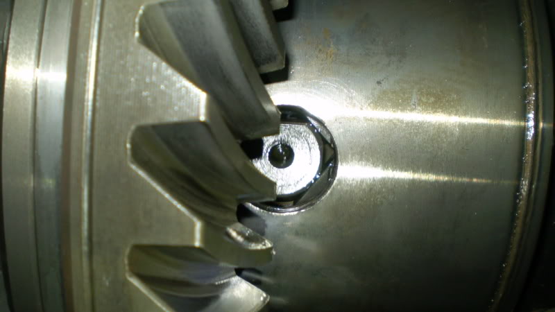

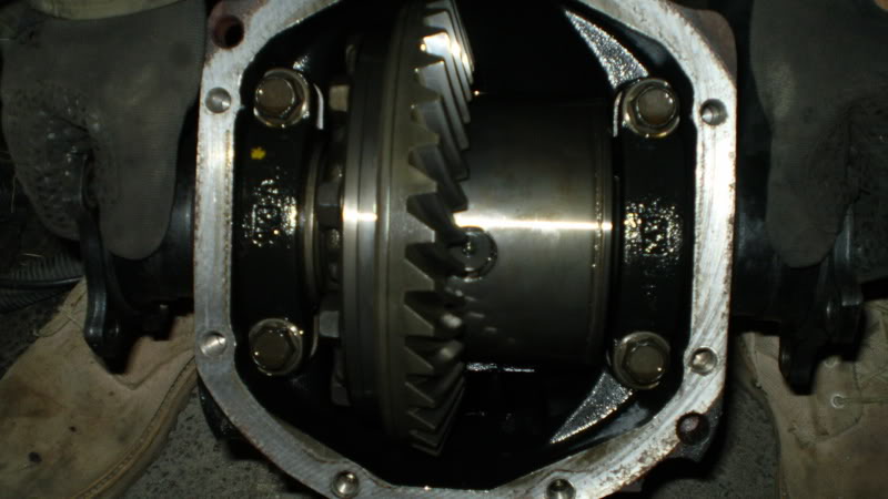

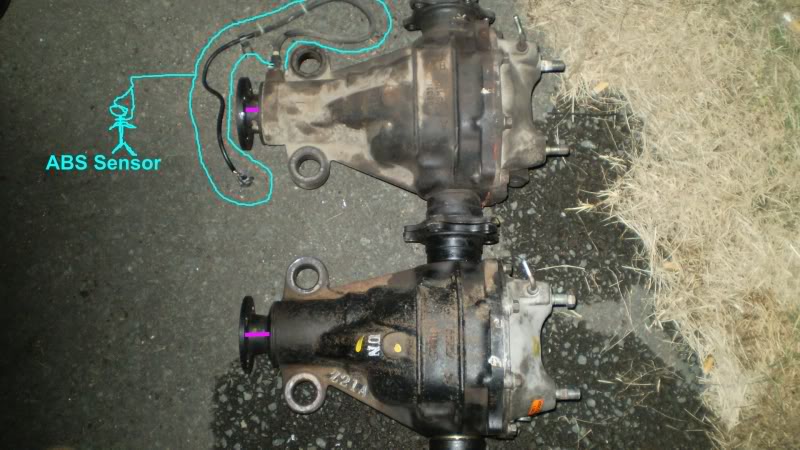

welp got a day off today...had to take advantage of it.
-went to junk yard.
-pulled non abs tail shaft off
-installed nismo 2way
-YAY
I don't use ABS... personal preference. The nismo 2way came in a non-abs housing. There really was no point in removing the diff to put it into my abs pumpkin. i went to the J-yard and grabbed the slightly longer Non-abs tail shaft in order to install the Non Abs pumpkin on my ABS equipped R33.
the pics show the difference in size

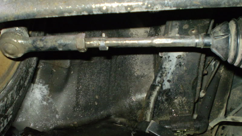

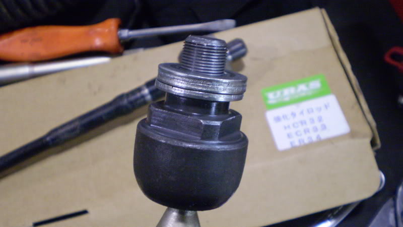

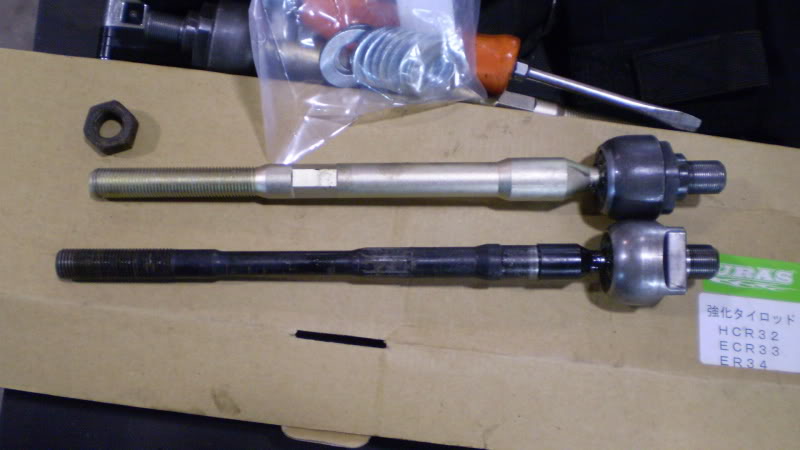

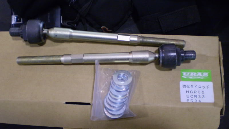

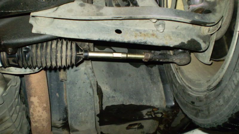

Uras Tie rods
Old Dec 21, 2008 | 12:53 PM
  #264
USMCDrifter's Avatar
Posts: 1,684
From: Alpharetta, GA
Yay, more snap oversteer . . .
Old Dec 21, 2008 | 11:10 PM
  #265
i just discovered this today also.... when i seen the catalog, i thought the washers were over the machined portion of the tie rod.. however like you said.. it goes inside the rack.. ill pick this up asap and change em out.
http://www.uras.co.jp/syohin/yokaparts.html
